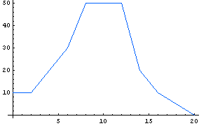

A 2,0 kg body moves along a straight line.
x={0,2,4,6,8,10,12,14,16,18,20} s
f(x)={10,10,20,30,50,50,50,20,10,5,0} m/s
a)
Make a acceleration-time graph
c)
Calculate the average force working on this body
I tried to make a acceleration graph. However, something is wrong with it.
c) First I tried to find the average acceleration,
a = ((v - v0)/(t-t1)) = (0 m/s - 10 m/s)/(20-0)) = -0,5 m/s^2
then
E = ma
= 2 kg * -0,5 m/s^2
= - 1 N
Can anyone correct me?
From the data given, both your graphs and calculations are correct. Why do you believe it be wrong?
~H
Ok. It is - 1 N, and not 1 N?
Yes, it is -1N from the given data.
