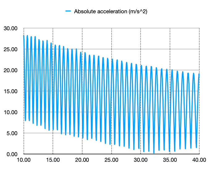

Hello, I’m busy doing a physics project on the friction force on different surfaces, like asphalt, grass, etc. I need to measure the data using an app called Phyphox, by taping my phone into the wheel of my bike, which gives me a graph of the angular velocity as the bike moves. However, the graph is not steady, it increments and decrements at random points. So how am I meant to calculate the approximate acceleration and THEN calculate the friction force? I was thinking of equaling the Friction force to m•a / m • g but I don’t know if this is correct, as the source I read this on didn’t seem trustworthy. All help would be grately appreciated, as this project is worth a 30% of my grade.
I hope you didn't really tape your phone to the moving wheel. You can get the motion information by just having somebody hold your phone to film you with that app, I'm pretty sure. Since your tires will likely not be slipping, you can calculate the angular motion of the wheels from the linear motion of the bicycle.
Thank you for your answer, I think I’ll give that a try to see if it gives me better results.

The experiment you described measures the centripetal acceleration. You need to measure the linear acceleration. You can do that by taping your phone on the bike frame.

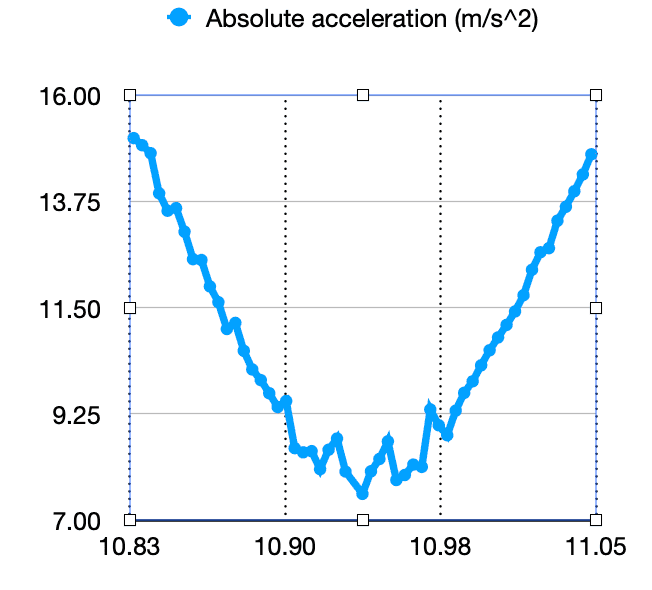

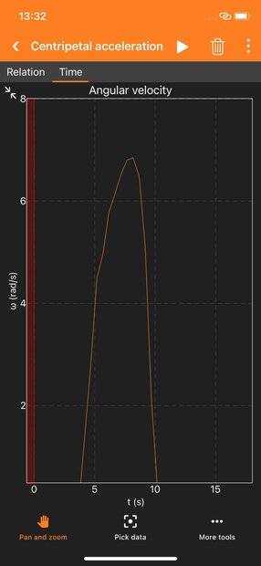

Please explain more details of what you did. E.g. did you attempt to accelerate as fast possible, producing a skid, so the acceleration of the vehicle would indicate the kinetic friction?
As noted, the acceleration measured at a non-central point on the wheel will be a combination of the linear acceleration of the vehicle and the centripetal acceleration. Since the angle between those two vectors is not constant the magnitude of the net acceleration will not be constant.
Weird. I downloaded the app to my phone and did a similar experiment. While your images indicate data collection roughly every half second, my device collected 250 data points per second!
And the angular velocity in your top graph went from maximum to zero in only 2 seconds? Guessing that was the 'grass' test?
And like your second graph, I also had noisy data.
while yours looks like you hit a mole hill or something...
In any event, this is a delightful project your instructor has imposed upon you and your classmates.
Hello! That looks like a more accurate graph than mine, and strangely enough I was riding on a flat road, no grass. What’s the name of that app? I think I’m going to try this one out for more specific results.

To begin my partner was on the bike, I tapped “record” so that the app would start measuring data and then he started cycling in a space of approximately 8 meters. That was all the data that the app gathered, it was more of a “test run” since we are still investigating to see if we can get more accurate results. If I accelerated and then produced a skid would I be able to calculate the kinetic friction for that specific surface?

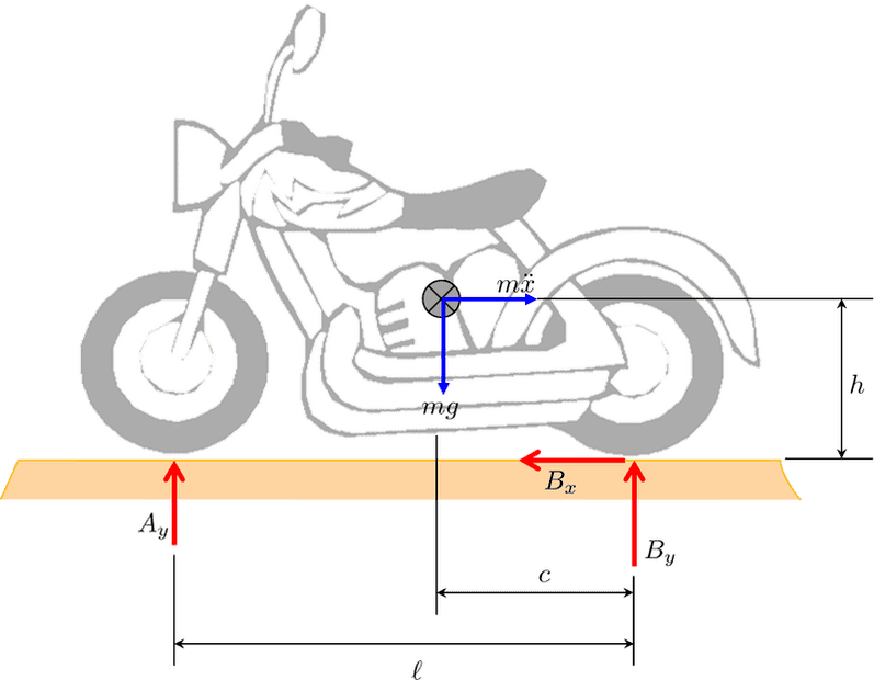

Use the rear brake only. It will be easier to skid and also safer. You then have to solve the same free body diagram as in post #4, except that ##B_x## and ##m\ddot{x}## will be negative (i.e. pointing in the other direction).

If the normal forces are ##N_{front}, N_{rear}## and both are skidding then the braking force is ##(N_{front}+ N_{rear})\mu_k=mg\mu_k##.

Not if the rear and front braking forces are not balanced with the normal forces acting on the tires, like, for example, when braking with one wheel.
