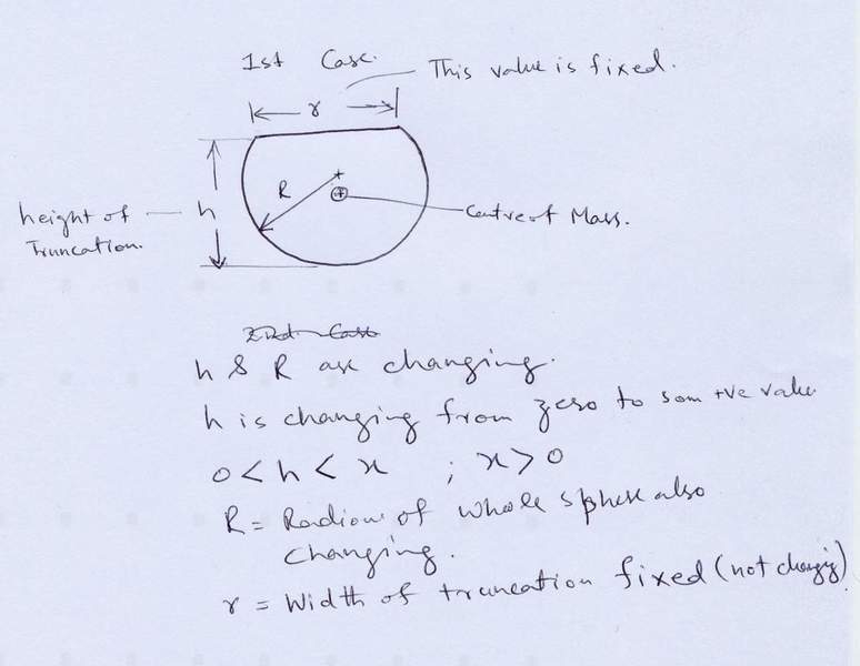

derivation of the centre of mass of the truncated sphere
i tried to solve it with triple integrals but i failed to figure ut the integral limits

Dear,
Please see the attached File
Please state the problem here, rather than referring to some other document I have to wait before opening.
i m sorry for that but i can not draw diagram in this page,thats why i send the attached image.
i m again sorry ,i don't want u to wait.
Well, I am unable to open the file prior to the mentor's approval of it.
Now, I'm not exactly sure what you mean by saying "h and R" is changing.
We have the relation:
[tex]h=R+\sqrt{R^{2}-(\frac{\alpha}{2})^{2}}[/tex]

dear can u tell what is alpha
Dear arildno,
Please explain about alpha ,i don't understand about it
Okay, I misread your [itex]\gamma[/itex] for an [itex]\alpha[/itex].
Sorry about that.
