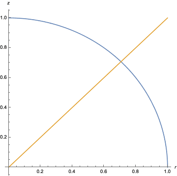

Does this plot help?

First of all, this is (much) easier to do in spherical coordinates than in cylinder coordinates.
Second, in the region that is above the yellow line and below the blue line in #3, clearly the ##r##-value is lower than the ##r##-value at the intercept.
