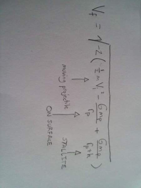

so i have the equation
Ki-Ui=Kf-Uf
wanting to solve for velocity at a certain point Uf actually is GMm/(R+H)
CORRECT?
So then I solved for Vf and get ...
squareroot (2(Ki-Ui+Uf)/m)
Then i plug and go...WHY ISN'T WORKING
You seem to have the basic idea.
Kinetic energy at firing + potential energy gravity at surface = potential energy at satellite + kinetic energy of projectile.
after plugging in the KE and PE equations i came up with...-2(-.5Vi^2+GM/R-GM/(R+h))
square root of the whole thing.
so instead of using the mass of the planet i should use mass of the sataellite?
EDIT: I don't have the mass of the satellite so I believe I have it set up right.
So then the way I set it up is right?
So long as you have also accounted for the potential energy at the surface as well.
I attached my equation.
D H said:
You forgot that the satellite is in orbit. It's moving, too.
you can't just assume it isn't moving?
I don't think they are asking for the speed relative to the satellite.
Merely the speed at the height (radius) of the satellite's orbit.
thats what I figured. I figured that they just wanted the distance. Is my equation correct that i attached a few posts back?
Looks like the - in front of the 2 is not useful.
I would examine they way you treated the mass of the projectile ... as a suggestion.
The mass should cancel. i meant to erase it, and the 2 shouldn't be negative. I just worked through that equation and it said the answer is wrong.
Opps that is my bad, I knew it canceled in my mind but when I re wrote it i forgot to cancel it even though I canceled the others.
EDIT: WHen i worked through it, i didn't use the negative or the mass and it was wrong

Maybe show your work? Perhaps you have a simple error?
Wouldn't it just be easier to use [tex]S(t)=-gt^{2}+V_{o}t+h_{o}[/tex]?
hmmmm i was never able to get it.
ok ill try to get that on here hold on.
