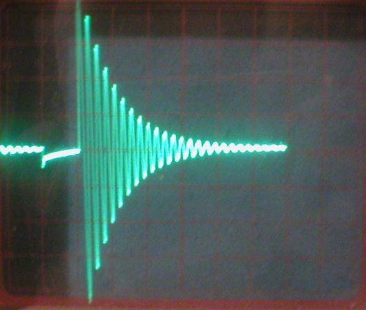

I am a SCENAR therapist, and I am looking for clarification on something which has confused me for a while. The SCENAR device stimulates the body to heal itself, by transmitting short impulses (measured in microseconds), which replicate neuro-impulses, the property of the impulse is such that it is able to penetrate the C-fibres in the skin, one impulse is as follows (I have connected it to my oscilloscope):

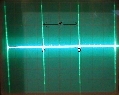

The following shows a number of regular impulses on a set frequency 1/Y (ignore the C and D)

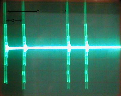

A setting on the device allows another impulse to come almost immediately after the first (represented by time X). This is called "intensity", when Int=2, it shows on the oscilloscope as follows.
I would like to know how to describe this resultant frequency in terms of X and Y

X (horisontal axis) is time in ms and Y (vertical axis) is Voltage, V
Regards
SCENAR Australia
I should not have used X and Y, any other algebraic characters would suffice.
In my images they are both time in ms
The "impulse" function (not really an impulse ie. dirac delta) can be described by a decaying sine wave. That is a sine wave that quickly dies off and repeats at frequency F.
Where
[tex]\omega[/tex] =[tex]2\pi[/tex] F
Basically:
[tex]Asin\omega[/tex]*e[tex]^{-t/\tau}[/tex]
where A is the maximum amplitude of the voltage, [tex]\omega[/tex] is basically the frequency of the sine wave, and the e[tex]^{-t/\tau}[/tex] defines how fast the sine term decays.
