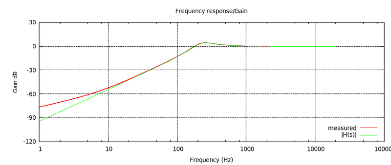

The following values give a perfect fit for the frequency response (ie gain, |H(s)|)
\omega_0 = 228.711
Q = 1.58195
look!
(freq_gain.png)

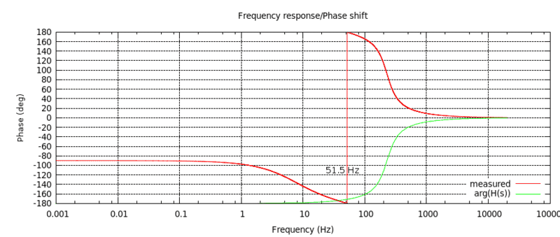

But when you look at the phase response, there is no fit at all:
(freq_phase.png)
(the phase jumps 360 degrees at 51.5 Hz)
So apparently, the transfer function is wrong or incomplete. Now my question is: how should the transfer function look like, to make sure both the measured frequency response and the measured phase response are perfectly captured in the equation?

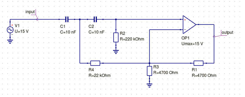

For your reference, here is the schematic that was simulated:
(hpf.png)

Welcome to the PF. Why is R4 there?
I guess maybe for the 2nd order transfer function? Can you link to the original circuit you are trying to simulate? (where did you get the original circuit?)
That phase doesn't jump! Phase angle wraps around (-180 = +180) and sometimes programs can't handle this wrapping correctly. That phase plot smoothly decreases from +270 to zero as frequency increases, that's all.
BTW. There is something else wrong with your plots. The green trace showing the phase of the stated transfer function should start at +180 and go to zero (not -180 to zero as shown).

If R4 were to have been connected to the output of the opamp (instead of the inverting input) then the circuit topology would have been precisely that of a second order high-pass "Sallen-Key" design. In this case you could just look up the transfer function of a Sallen Key filter and plug in the component values. As it is the circuit is a fair bit harder to analyse (but still do-able).
BTW. "Sallen-Key" was a very popular (and somewhat a standard) topology for active filters back in a their day.

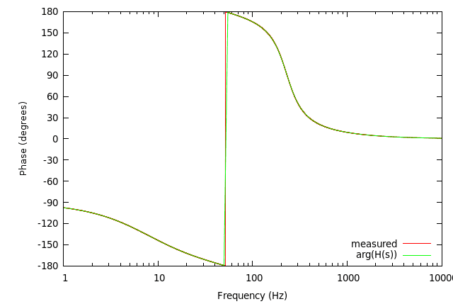

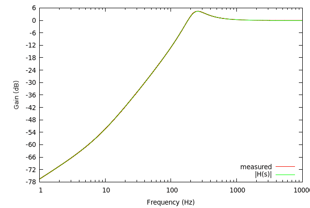

it could be a lucky shot, but found that a small change to the transfer function would give a perfect fit:
H(s) = \frac{s^2 + a s}{s^2 + \omega_0/Q s + \omega_0^2}
a new term has been added to the numerator: a s
The following values give a perfect fit for the frequency response and the phase response:
\omega_0 = 228.711
Q = 1.58195
a = -7.72458
see attached plots

Hi kvtb, quick question. What software are you using? I think it may be leading you astray as I question whether that phase response belongs to either that circuit or that transfer function.
Are you certain that the circuit diagram you posteed is the same one you're simulating?

Ok it mostly looks good. I still think that the "measured arg(H(s))" shown in green in your first post is the negative of what it should be, but the phase angle shown in red now looks good except for the "wrap around" issue.
You should read that phase as a continuous decreasing function, starting at -90 degrees and finishing at -360 degrees. Remember that in the context of steady state AC analysis that multiples of 360 degrees are meaningless, so you can just as well read that phase as going from +270 degrees down to 0 degrees.
BTW. It turns out that the circuit really is precisely a Sallen-Key HPF from Vin to the opamp input. I analysed it (by hand) and got the following transfer function.
\frac{v_+}{v_{in}} = \frac{s^2} {s^2 + \frac{2}{R_2 C} s + \frac{1}{R_2 R_4 c^2} }
What makes the circuit different is that the op-amp is no longer just a simple gain of two, because of the contribution of the current through R4 you get a whole another frequency response just from the opamp input to opamp output. I didn't analyse that part fully but I'm now confident that it does indeed introduce another zero, exactly as you had empirically deduced in your last post.
Hang on. No there's still something bothering me about those results. I believe the results of the circuit simulation but I don't believe that the stated transfer fuction can give those phase results.
I can tell you for absolute certain that
will not give the phase response shown. There is abolutely no way that is going to give the 270 degrees phase shift as shown - just can't happen.
Edit : I take that back. I was thinking that "a" was a positive constant. I only just noticed that you stated that "a" is negaive. That totally changes things, when "a" is negative then it does indeed give the phase response as indicated.
Still one thing that seems wrong. That circuit definitely has a gain of 2 (6dB) in the pass-band though the simulation shows zero dB. ?
I get a transfer function from V1 to opamp output of:
\frac{Vo}{V1} =(1+\frac{R_1}{R_3}) \frac{s^2-\frac{R_1R_3}{(R_1+R_3)R_2R_4C_2}s} {s^2 + (\frac{1}{R_2 C_2}+\frac{1}{R_2C_1}) s + \frac{1}{R_2 R_4 C_1C_2} }

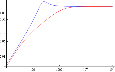

This circuit is a little unusual in that the right end of R4 is connected to the minus input of the opamp, rather than to the output of the opamp.
I've attached two plots. The first shows the gain response of the given circuit in blue, and also the gain response if the right end of R4 were connected to the opamp output.
The second plot shows the corresponding phase responses.

Yes I also analysed the TF from op-amp input to op-amp out last night to complete the overall response and got exactly the same answers as you "The Electrician". Good work. :)
I got :
\frac{v_{out}}{v_{in}} = \frac{2s (s - \frac{R}{2 R_2 R_4 C})} {s^2 + \frac{2}{R_2 C} s + \frac{1}{R_2 R_4 C^2} }
Where R is R_1 = R_3 and C is C_1 = C_2.
The right half plane zero means it's not a "mininum phase" system. The numerator phase runs from +270 degress back to +180 degree (rather than from +90 through to +180 as it would in a minumum phase system).
