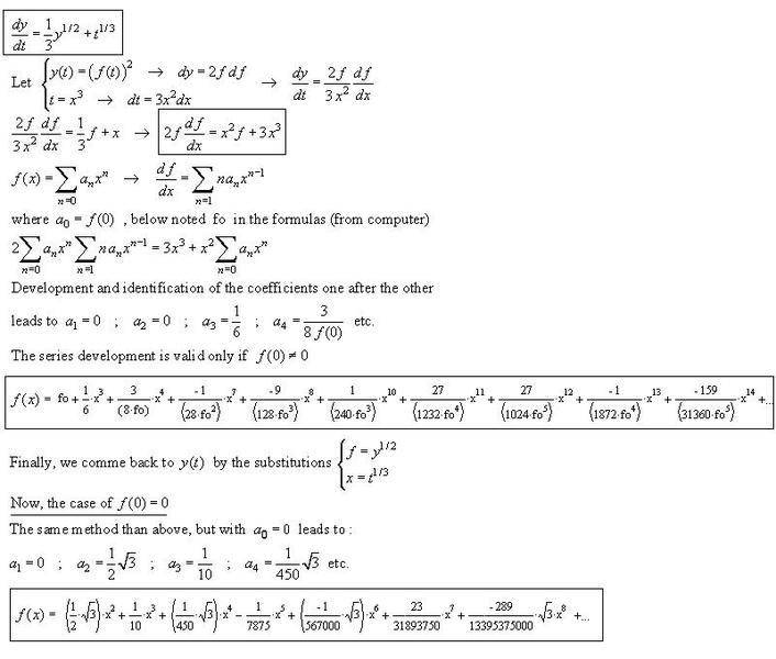

Hi Guys !
I am not a Jedi, so I let the most honorific job for them.
I did only a subaltern job which consists in expressing the result in terms of series development.
To be honest, I confess that my devoted computer did the even more subaltern work, which in fact is almost the whole, while I had a drink.
Well, have a look at the joint document.

Wait, let me check . . . yep, that's you alright. Startin' to look like it to me. Anyway, that's really nice Jacquelin. I think it would be nice to verify that solution, say numerically to some acceptable level of precision. And how does one compute the radius of convergence? I have problems figuring that out when a Cauchy product is involved.
