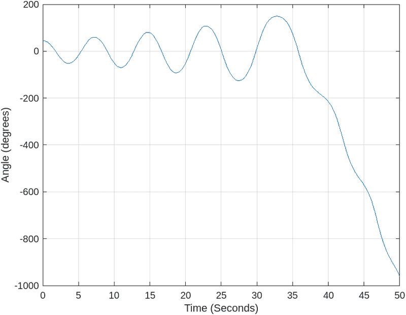

Hi everyone,
I am going through the book called "Numerical Methods for Engineers" and I am trying to solve for the angle of displacement of a pendulum. I am using MATLAB to do this. However, I am getting some strange results.
In the book the differential equation is:
Equation d²θ/dt² = −(g/l) sin θ, the pendulum equation of motion written with second derivative of angle θ with respect to time t.
Because this is a second order differential equation, I have converted it to two first order equations so that I can solve it using Euler's method.
So I get:
Equation dz/dt = -(g/l) sin θ, written as a fraction on the left with a minus sign, g over l, and sin θ on the right.
Equation dθ/dt = z, a first-order differential equation with dθ/dt on the left and z on the right.

Code:
g = 9.81;
l = 0.2;
t = 0:0.1:50;
dt = t(2) - t(1);
z(1) = 0
theta(1) = 90;
for i = 1:length(t)-1
    theta(i+1) = z(i)*dt + theta(i)
    z(i+1) = -(g/l)*sind(theta(i))*dt + z(i)
end
This is the graph
Line graph of Angle (degrees) against Time (Seconds) from 0 to 50, showing an oscillating curve whose peaks grow and then the trend drops steeply below -1000 degrees by 50 seconds.
This does not look correct to me. The amplitude of the graph should decrease as the time goes on correct?
Can someone help please?
Any attempt to model physical processes on the basis of forces and accelerations suffers from cumulative errors in the integration. A steady increase in the system's energy is not unusual.
Reducing the time step will improve it but not cure it.
No, because you have not modelled any losses. The true result would be constant amplitude.
The eventual runaway in your chart is where the angle reaches 180°, so the pendulum goes over the top, spins right round, and goes faster and faster.
A crude fix is to assess the total energy at each step and tweak the velocity or angle to keep it constant. That's not really satisfactory because you could not use that if modelling friction, for example.
To understand the details, consider the downward trajectory. You calculate the acceleration for the next interval, but the acceleration is reducing, so the acceleration you use is greater than the average acceleration will be.
In your code, you calculate the new position then calculate the new velocity (z) based on the acceleration at the old position.
Edit: See post #8
You would do better to base it on some weighted average of the old and new positions. Could be a simple average, or there might be a better weighting.
Whether it is better to average the positions then take the sines or take the average of the sines I'm not sure without more detailed analysis.
One problem is that angles are measured in radians in math. In your numerical solution, you're using degrees. You'll need to put in a conversion factor, or more simply, use radians in the numerical solution.
Ideally, the amplitude of the oscillation shouldn't decrease because you haven't included any friction.

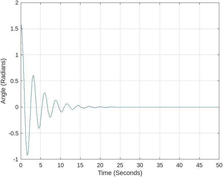

I was looking at Jeffrey Chasnov's videos on Youtube and he provided the equation which is:
Equation of a damped pendulum: m l times d²θ/dt² plus c l times dθ/dt plus m g sin θ equals 0.
I tried it in MATLAB and got this behaviour:
Line plot of angle in radians against time in seconds from 0 to 50, showing a damped oscillation that starts near 1.6, swings between about -0.9 and 0.6, and decays to zero by about 25 seconds.
I have to be careful however, for my damping (c value). If it's too high, the pendulum does not oscillate.
I might be wrong, but if the damping is higher than the damping ratio, is this when the system will not oscillate???

Here is a nice site which discusses the levels of damping with simulations; It answers your question better than I can say it.
https://www.physicsandstuffiguess.com/pendulums/pendulumFriction.html
Thanks for that, bob012345.
I was experimenting with my damping value and got underdamped, critically damped and overdamped responses.

That is the correct expression if [itex]\theta[/itex] is expressed in radians. It is not the correct expression if [itex]\theta[/itex] is expressed in degrees. This is your first mistake.
Note that I changed your image insert into a MathJax (LaTeX) equation. This is far preferable to images.
This is your second mistake, and it is a huge one. When you convert a second order ODE to a first order ODE your are throwing key aspects of geometry under the bus. Euler's method is the worst numerical integration technique. Combine these two factors (throwing out geometry and using Euler's method for a second order ODE) and you will inevitably get behavior shown in your graph. Explicit Euler's method tends to gain energy, even when energy should be conserved. That artificial energy gain due to a lousy choice in numerical integration technique is what happened here.
There are many numerical integration techniques, some very complicated, but some as simple as the explicit Euler's method you used, that do a far better job than does the explicit Euler method. A very simple approach is to swap lines 11 and 12 in your code: Calculate z(i+1) before calculating theta(i+1) and then use use z(i+1) instead of z(i) to calculate theta(i+1).
This simple change results in the symplectic Euler method and this comes very close to conserving energy.

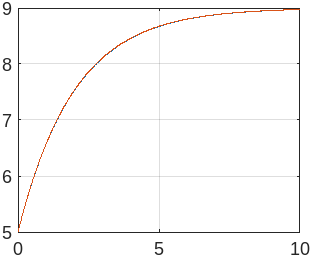

Really? I practised with a couple of differential equations and found Euler's method to be accurate if the step size is small enough. I used second order and converted them to two first order equations.
I chose:
$$ 4y'' + 2y' = 0 $$
and

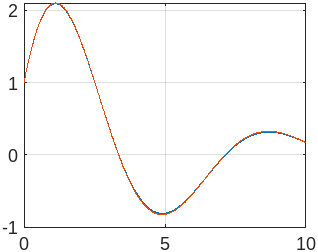

$$ 4y'' + 2y' + 3y = 0 $$
The analytical solution for these respectively are:
$$ y = 9 - 2exp(-t/2) $$
Initial conditions $$ y = 5, \frac{dy}{dx} = 2 $$
and
$$ y = exp(-t/4)(cos(\frac{\sqrt(11)}{4}t + 2.7135sin(\frac{\sqrt(11)}{4}t) $$
initial conditions $$ y = 1, \frac{dy}{dx} = 2 $$
Here is the MATLAB Code:
Code:
dy = 9 - 4*exp(-t/2); % analytical solution
y(1) = 5
z(1) = 2
    z(i+1) = (-1/2*z(i))*dt + z(i);
    y(i+1) = z(i)*dt + y(i);
end

P = exp(-t/4).*(sol(1).*cos(sqrt(11)/4.*t) + sol(2)*sin(sqrt(11)/4.*t)); % Analytical solution
y(1) = 1
z(1) = 2
    z(i+1) = (1/4*(-2*z(i) - 3*y(i)))*dt + z(i);
end
nexttile
plot(t,P,t,y)
grid on
Here are the results respectively:
Line plot of a curve rising from 5 at x=0 toward about 9 at x=10, with the red and blue curves overlapping almost completely.
Line graph of a damped oscillating curve from t = 0 to 10: it starts near 1, peaks near 2 around t = 1, dips to about -0.8 near t = 5, then rises to about 0.3 near t = 8.5. Two nearly identical curves, blue and red, overlap almost exactly.
As you can see the results from the analytical solution and the numerical solution are identical. The red covers the blue perfectly.

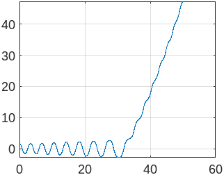

Were you able to get an accurate numerical solution to your original undamped system after fixing the problem with the units?

Unfortunately, Vela, no. It is still behaving like haruspex said.
Line graph of a curve plotted on axes from 0 to 60 horizontally and about 0 to 45 vertically; the curve oscillates near zero from 0 to about 30, then rises steeply with wiggles toward the top right.

Did you try the tweak D H suggested?

Ah I see. It would be interesting if we could compare the results I posted in post #12 (I don't know how to solve the analytical equation for that). The behaviour from that looks like it could be okay.
It will look saner merely because the drag term in the equation prevents the runaway behaviour, but it is not likely to make the discrepancy go away. Modelling it with Euler will still have it not decaying fast enough.
Btw, the equation in post #12 has a linear drag term. That's ok for small oscillations of a real pendulum (in which case, might as well replace ##\sin(\theta)## with ##\theta##), but for larger oscillations the drag will probably approximate quadratic through the bottom of the arc. It gets messy.
Please show you latest equations and setup. Your period still seems too large. Also, just for a benchmark, you might try just putting your differential equation directly into a solver such as Wolfram Alpha and let it solve it. In other words, don't try to use any numerical technique.
I do not see how that is inherently better in general. It merely approximates the average value of the angular velocity over the interval as being the value at the end of the interval instead of that at the start of the interval. A more convincing tweak would be to use the average of those two values, even though that might happen to give an inferior result in the pendulum case, as shown below.
The reason the change as you suggest does produce a big improvement in the pendulum case is quite subtle.
It happens that for a pendulum ##\theta, \alpha## always have opposite signs and ##\omega, \dot\alpha## likewise. As a result, each step of the post #1 algorithm overestimates gains in both KE and GPE and underestimates losses. Using the angular velocity at the end of the current step to estimate the angle change switches that around for GPE, so now the two errors tend to cancel.
We should not expect that benefit to carry over to differential equation modelling in general.
The mean value theorem says that for every smooth function ##f(x)## and and every interval ##[a,b]## over which ##f(x)## is defined, there exists some ##c \in [a,b]## such that ##f(b)= f(a) + (b-a)\,f'(c)## . In other words, there exists some magical intermediate point such that the derivative at that point can be used to exactly compute the next value in the sequence ##\{(t_0, f(t_0)),\, (t_1,f(t_1)),\,\cdots\}##. The trick is to find that magical point, or equivalently to find the magical derivative value.
It's not subtle because of this behavior. It is even more subtle than you think, and to address your final line, it most definitely carries over to many other places where numerical integration of a differential equation is computed. The underlying ODE in this case is a second order ODE. Rewriting a system of ##N## second order ODEs (e.g., one per axis) to a system of ##2N## first order ODEs is possible, but doing so throws out geometry. That a plane pendulum is a system of second order ODEs is one aspect of "geometry". Another aspect of "geometry" is that an undamped plane pendulum can be expressed as a Lagrangian or Hamiltonian. Sympectic Euler is the simplest symplectic integrator that does not throw out geometry with the bath water. A symplectic integrator conserves a very close analog to energy in situations where energy is conserved.
An even better approach is the leapfrog technique, which can be written as
[tex]\begin{aligned}<br /> a_i &= f(t_i, x_i, v_i) \\<br /> v_{i+1/2} &= v_i + \frac12 a_i \Delta t \\<br /> x_{i+1} &= x_i + v_{i+1/2} \Delta t \\<br /> t_{i+1} &= t_i + \Delta t \\<br /> a_{i+1} &= f(t_{i+1}, x_{i+1}, v_{i+1}) \\<br /> v_{i+1} &= v_i + \frac12 a_{i+1} \Delta t<br /> \end{aligned}[/tex] where ##a_i## is the acceleration at time ##t_i## calculated by some derivative function ##f(t_i, x_i, v_i)##.
Note that
  • If the derivative function ##f(t,x,v)## does not depend on velocity then it only needs to be computed once for the initial sequence and then only once for each subsequent sequence as the penultimate step of the prior sequence already computed ##a_{i+1}##. This is the case for the drag-free pendulum.
  • If the derivative function does not depend on velocity or time then energy is a conserved quantity . This is where symplectic integrators shine because their derivations explicitly conserve a quantity that is a very close analog of energy. Even when this is assumption only approximately true (e.g., small perturbations based on time and/or velocity), a symplectic integrator will still tend to perform much better than a similar non-symplectic integrator. There are plenty of places on physics where energy is close to a conserved quantity.
  • If on the other hand, the derivative function does depend on velocity, the penultimate step (##a_{i+1} = f(t_{i+1} + x_{i+1}, v_{i+1})##) cannot be computed without an estimate for ##v_{i+1}##. This makes the last two steps implicit. There are many ways to deal with this.
