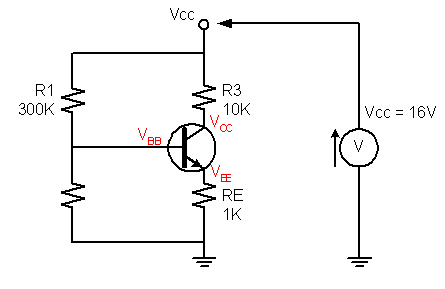

Given the following transistoric circuit. The transistor acts in the active region. In addition: VBB = 0.6V
http://img855.imageshack.us/img855/9901/newcircuit.jpg
Before I get there I have two questions:
1) What does it mean that the transistor acts in the active region?
2) VBB is not the drawing. Why does it matter to me what it equals to if I can't see it?

When a transistor is "acting in the active region", it means that it is operating in the region of its characteristic curves where it is behaving essentially linearly. That is, it is not biased to cutoff (no collector current flowing) or to saturation (where small changes in base current are ineffective at altering the collector-emitter current).
Hmm...I'm not sure what you mean by "not biased to cutoff"...in fact that explanation kinda confused me. Can you try to write it differently maybe it would help, please?
VBB is the designation for the base voltage with respect to circuit ground.
Hmmm.

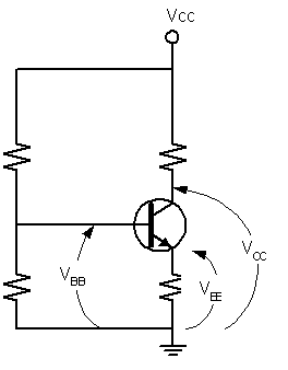

I've circled in red where I think VBB is, VEE is and VCC is. Is that correct?
http://img269.imageshack.us/img269/8585/cccircledinredok.jpg
Biased to cutoff means that the base voltage drops below the threshold required for base current to flow; the base-emitter junction behaves like a diode, and you need to forward bias a diode in order for current to flow. If the base-emitter voltage (Vbe) drops below this forward bias threshold (about 0.7V for a silicon transistor), then base current will stop and and the collector-emitter current will be shut off, too. The transistor then "looks like" an open circuit for collector-emitter current, and the base can no longer actively control that current.
Similar things happen at what is called "saturation". So much base current flows that the transistor is "fully on" -- the tap's open as much as it can go! No further increase in base current can cause more collector-emitter current to flow, and that current becomes essentially insensitive to small changes in base current.
Regarding the VCC, VBB, and VEE designations, have a look here:
They designate the DC voltage with respect to ground at the collector, base, and emitter terminals of the transistor. It is perhaps an unfortunate fact that traditionally the supply voltage that provides the supply voltage for the circuit has also come to be called "Vcc"... so one needs to be a bit careful to distinguish between that supply voltage and the VCC that exits at the transistor terminal when a collector load resistor stands in the path between them. Usually the distinction is made clear by statement or context in a given problem.

Just so I make sure, because it's sometimes hard for me to see the voltage source: is this it?
http://img651.imageshack.us/img651/9761/thecirrrrrrrrrrcuit.jpg
Your original image showed the voltage source Vcc connected above the collector load resistor R3 (at the little circular connection point at the top of the circuit). So you can think of having a 16V battery (Vcc is given as 16V) connected between that point and the ground node. Again, keep in mind there's the possibility of confusing VCC the collector potential (w.r.t. ground) and the power supply Vcc.
And I just simply use Kirchhoff laws and the transistors formulas (with the beta/IE/IC/IB stuff...) to solve it?
Yes, that's more or less it.
Yes I copied it exactly.
Are you sure? Like this?
http://img52.imageshack.us/img52/4740/likethist.jpg
But why did they mark a plus and a minus like in the original image if that's not where the voltage source is?
I'll keep that in mind, though I fail to understand why they'd call it in similar names.
The power supply connection (Vcc) looks like this:
Note that Vcc is not the same as VCC.
Ah! That + and - are designating where the output of the circuit is considered to be. I suppose that at some point you'll be asked to find the voltage at the collector (with respect to ground), and perhaps, with some small signal being applied at the base -- you will see that that signal has been both amplified and inverted.
I doubt that it came about through a committee vote :smile: It's one of those things that are put down to "historical reasons".

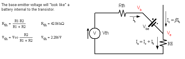

Hi FP! :smile:
Are you familiar with http://en.wikipedia.org/wiki/Voltage_divider" ?
(just follow the link)
With this knowledge you can calculate
precisely what Vbb is. (Hint: it is not 0.6V)
I suspect your instructor meant to say Vbe = 0.6V (the turn on
voltage between the base & emitter junction of your transistor)
Armed with Vbb, using KVL, you could make an equation
from that point through base-emiitter junction, through Re to ground potential.
There would be only one unknown variable in that equation.
By solving, you would know the value of that variable. :cool:

Vcc, Vbb, and Vee are generally the names of voltage sources for the colllector/base/emitter respectively. That's what he told me, anyway.
Hi FP!
Are you familiar with voltage division?
I "think" I do. I may have used it in the past not knowing the name.
You're right. I talked with him about it today and there's a misprint - it's VBE = 0.6V
Alright then!

They are electrically identical. Any points connected by a conductor (wire) must be at the same potential, and are the same node electrically. The ground connections represent a common conduction path for anything connect to it via the "ground" symbol.
My instructor said it's best not to use 2 Vcc's. But rather to call the arrows to the ground point you drew here
http://img840.imageshack.us/img840/900/tocall.jpg
As Vc, Vb and Ve.
That works fine. There are various conventions used by different books, authors, schools, etc.. As long as you understand what particular potential or current is being referred to there should be no problem. Choose a naming scheme and stick with it throughout a given problem.

Femme_physics said:
In your second loop you write:
Sum V = 0; Vcc - R3Ic - REIE = 0
But you're forgetting the voltage VCE here, which is not zero.
However, if you work it out properly, there's still something wrong with the numbers in this circuit. They are wrong to make physical sense, as gneill already noted.
Note that you found a beta = 0.1111.
Actually you made a mistake (as I already noted), but you should know yourself that beta is an amplification factor, typically greater than 10.
"Trust your physical cues!" :smile:

Is there more to this problem than has been shown so far? I haven't seen an actual statement about what specifically is to be determined.
Find Beta
Find voltage on Re (VRE)
Find voltage on R2 (VR2)
Ah, I thought that's the link I might have been missing.

Duly noted! Though I'm once again finding myself building too many equations and too many unknowns. Any hints?
Well, basically you have 2 loops.
That should give you 2 KVL and 1 KCL equation.
You've done that before.
What have you got so far?
Your first equation was right in the previous scan, now it's not.
You second equation is good now.
In your third equation you should have a plus sign instead of a multiplication dot.
I don't understand what your 4th equation is. What is IT?
You can already find IC by looking just at R3 and the voltage difference across it.
Furthermore, you don't have R2 in any loop yet, and you should, so I guess there's a third loop you should consider.
But I've added the missing link this time (Vce), how can it be wrong?
Oops :shy:
You're right, it must equal 8!
Good :approve: At least that!
You're right! I haven't thought of that! :approve: !
Duly noted. Working on it! :smile:
Before you had 2 equations.
The first was right. This loop included Vo, which means you're not taking your loop through the transistor, and so Vce is not part of the loop.
The second equation was a loop that did go through the transistor.
That equation was missing Vce.
However, you've left this equation out now.
But that's okay, because you've included a new loop that also walks through RE.
Since you do not need to calculate Vce, you don't need the equation that has it.

Say, FP, have you covered Thevenin equivalents yet? The reason I ask is that it is sometime convenient to replace the base bias network with a Thevenin equivalent voltage and series resistance.
No and I'm not sure if I should, it's not in the scope of my course. Unless it's easy. ILS, what do you think? Should I?
Oh, wait. I don't need to consider Vce because Vo already considers THAT and IRE. So my IC should still be correct. No? Just look at this.
http://img687.imageshack.us/img687/9420/thatlook.jpg
The blue dots. That's the voltage difference. It already includes Vce. So I didn't ignore it, most certainly didn't!
Nope. You didn't this time round. :smile:
