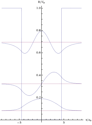

@olgerm Have you solved the exercise of finite well potential e.g., Wiki https://en.wikipedia.org/wiki/Finite_potential_well ? It would give you a good insight.
In solving Shrodeinger equation, two parts in the well and in the wall are connected.
In the well : ##e^{ikx}## wave type
In the wall : ##e^{-\kappa x}## exponential decay type,i.e. permutation into the wall or tunneling effect when wavfunction go through to another free region beyond if any.
With momentum eigenfuction ##e^{ikx}, k=p/\hbar, -\infty<x<+\infty## in mind, we are tempted to think "In the well the particle has classical to and fro momentum and in the wall it has imaginary momentum which generates negative kinetic energy". What do you think of this ?
It's the wrong way to think about QT. You calculate the energy eigenvectors and eigenvalues, i.e., you determine in which states you particle has a definite energy. Since ##[\hat{H},\hat{p}]\neq 0##, usually these are not eigenvectors of ##\hat{p}##, i.e., the momentum has no definite value, but you can only predict the probabilities which result you get when measuring the momentum of the particle.
