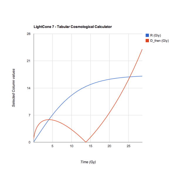

That's a good dynamic image but you know that most of the galaxies we are seeing today emitted the light we are getting when they were receding faster than light, so the light was initially losing ground. In other words there are some complications and subtleties that an escalator or moving sidewalk doesn't get. For example the SPEED of distance growth is proportional to the size of the distance. A feature that the escalator doesn't have. But there's a place for such analogies, or, say, a swimmer or a boat trying to go upriver.
There's a good visual illustration of a photon or flash of light getting swept back at first and loosing ground, and then holding its own, and then gradually making progress and eventually getting there! What this does is show the track. Getting farther away at first. The distance from us rising at first, leveling off, and then sloping down and getting less and less as it approaches us.
This is how to get the picture. It's easy to graph curves, good skill to pick up. Basically 3 clicks.
Open http://www.einsteins-theory-of-relativity-4engineers.com/LightCone7/LightCone.html
Click on "chart" and "set sample chart range"
Click on "column definition and selection" and UNCHECK everything except Time and Dthen
Press "calculate"
Dthen is the distance from us back THEN (at the indicated time) of a photon which is eventually going to get to us and will arrive today. So you can see it increase at first. And then get smaller and hit zero at present-day which is year 13.8 billion.
After that, the curve tells the story of a photon or flash of light that we send out today, so you can see it getting farther and farther, actually helped by expansion (rather than being hindered as the incoming light was.)
Press "calculate"
So I followed the "3 click" recipe I described above, with one difference, that I did not uncheck the Hubble radius. The size distance that at any given time is expanding at speed c. Including that curve gives us a handle on how the expansion rate changes over time. So here's the picture. You can see the photon is dragged back at first, then at a certain point its forward motion is exactly canceled and the slope is zero (neither gaining nor losing ground). And then it begins to close the distance to its destination (us.) It arrives in year 13.8 billion, at which time you can see the Hubble radius is about 14.4 billion ly.
The red curve is the photon's proper distance from us. The blue curve is the Hubble radius. They cross where the photon is making zero progress because its distance is increasing at speed c, just canceling. The swimmer is swimming exactly the same speed as the current setting him back.

BTW Timdeeg, if you would glance back to post #21 and take a look at the graph of the red curve (Dthen) and the blue curve (Hubble radius R).
Do you find it easy or natural to understand the red curve as showing the progress towards us of a photon emitted very early on, say before year 1 million, that arrives here today?
Also how easy is it to read the blue curve as showing, in effect, the reciprocal of percentage distance growth rate?
For example where red curve hits zero is the present (the photon arrives). And looking up from the present you see blue curve is about 14.4. That means distances are growing, at present, at rate of 1/144 percent per million years.
As other example, where red and blue cross is, we can see by eye, around year 4 billion.
And at that time blue curve is about 5.9. I think you can see that by eye too, or call it 6.0.
What that means is that in year 4 billion distances were growing at 1/60 percent per million years.
You can also see from that blue and red crossing why the photon eventually makes it to us. because from that time onwards its distance from us is less than the Hubble radius.
Hence the recession speed of space it's traveling thru is less than c. so it gains ground.
Whereas before year 4 billion it had been losing. The distance it still had to go to get to us was increasing, because the red curve is ABOVE the blue---i.e. it was beyond the Hubble radius.
I think that figure in post #21 defines the target level of understanding that I would aspire to for newcomers. The blue curve shows how the percentage distance growth rate is declining (because it's reciprocal is rising) and the red curve shows how expansion HINDERS an incoming photon and HELPS an outgoing (looking at the flaring-out section of curve in future time).
