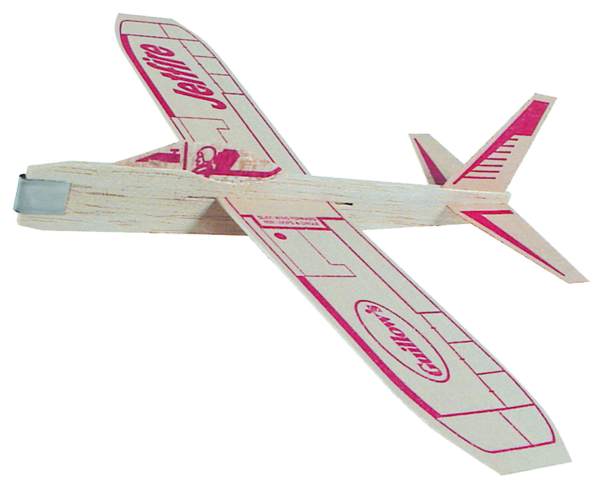

This model always worked for me:
Photo of a balsa wood model glider with pink printed panel lines, a cockpit outline, a tail fin, and the word Jetline printed on the wing and fuselage.
There was also a version with a high power elastomer based engine, as I recall.

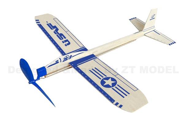

Balsa wood model glider with blue and white markings, a blue folding propeller at the nose, and a blue star roundel with stripes on the wing; the fuselage and fin show blue striping and printed text.
That model worked too.
