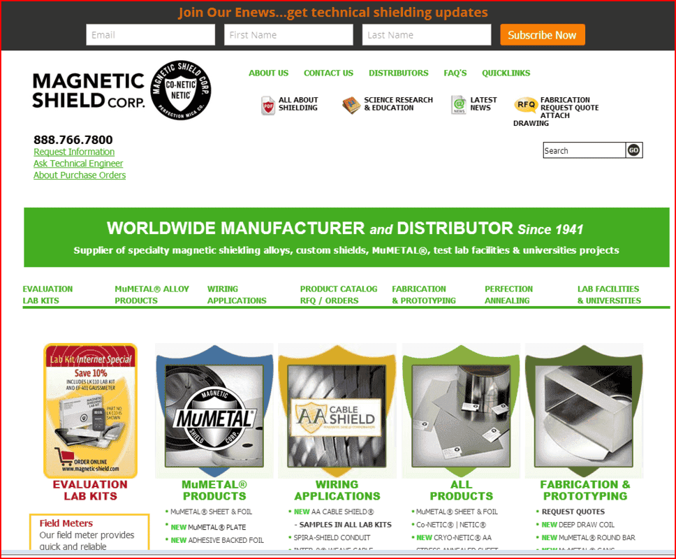

I'm not familiar with the "pure iron" example you gave earlier. In our products, we generally use mu-metal shields, sometimes with the netic/co-netic combination to optimize the shielding properties.
Check out the Shielding Tutorials at this website below (we use them for most of our magnetic shielding needs). Click the "ALL ABOUT SHIELDING" link at the top of that web page to get to the long list of their tutorial pages. :smile:
http://www.magnetic-shield.com/index.html
