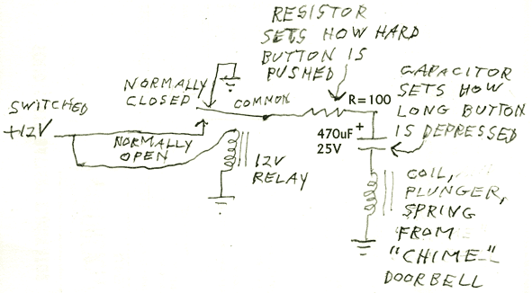

How about without the the Raspberry and servo?
Use a SPDT (Single Pole Double Throw) relay, resistor, capacitor, and parts from a "chime" type doorbell.
This will push the button every time the power turns On or Off. Be aware that it does not sense whether the camera is already On or Off, it just pushes the button.
Operation:
  1. Power (+12V) is Off. Relay N.C. (Normally Closed) are closed. Capacitor is discharged.
  2. Power On. Relay N.C. Open, N.O. (normally Open) Close. this applies power to Res., Cap., Doorbell.
  3. As Capacitor charges, current flows thru Doorbell causing plunger to hit Camera Button.
  4. When Capacitor is charged, current stop. Doorbell plunger is retracted by spring.
  5. Power shuts Off. Relay switches, closing N.C. contacts.
  6. As Capacitor discharges, the current flows thru Doorbell causing plunger to hit Camera Button.
The Resistor (100 Ohm) and Capacitor (470uF) values are initial guesses. You will have to try different values to get the needed timing. The values will interact to some extent.
Oh, and be sure to wire the Capacitor with the correct polarity as shown. They really stink if you get them backwards, and they don't work any more.
Have Fun! And let us know how it turns out.
Cheers,
Tom
