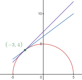

The function f is defined by
$$f(x)=\sqrt{25-x^2},\quad -5\le x \le 5$$
(a) Find $f'(x)$ apply chain rule
\dfrac{d}{dx}(25-x^2)^{1/2}
=\dfrac{1}{2}(25-x^2)^{-1/2}2x
=-\frac{x}{\sqrt{25-x^2}}$$
(b) Write an equation for the tangent line to the graph of f at $x=-3$
$$f'(-3)=-\frac{3}{\sqrt{25-(3)^2}}
=-\dfrac{3}{4}=m$$
then f(-3)=4 $y=mx+b$ so $y=-\dfrac{3}{4}(x+3)+4$
(c) Let g be the function defined by $\biggr\{\begin{array}{ll}
f(x) &\textit{for } -5\le x \ge 5\\
x+7 &\textit{for } 3\le x\le 5
\end{array}$
Is g continuous at $x=-3$ (d) Find the value of
$\displaystyle
\int_0^5 x \sqrt{25-x^2}\, dx$
ok i think a and b are okbut (c) x+7 is not a tangent line but looks continuous by the inequalities(d) I assume they tossed in the x for a u substitution method.
=\dfrac{1}{2}(25-x^2)^{-1/2}{\color{red}(-2x)}
$$f'(-3)=-\frac{{\color{red}(-3)}}{\sqrt{25-{\color{red}{(-3)}}^2}}
={\color{red}{+}}\dfrac{3}{4}=m$$
then f(-3)=4 $y=mx+b$ so $y={\color{red}{+}}\dfrac{3}{4}(x+3)+4$
f(x) &\textit{for } -5\le x \ge 5 {\color{red}{\text{ ?}}}\\
\end{array}$
Is g continuous at $x=-3 {\color{red}{\text{ ?}}}$ (d) Find the value of
$\displaystyle
(c) check the intervals of the piece-wise function again and the point where continuity is in question
(d) use substitution and evaluate
Let g be the function defined by $$\biggr\{\begin{array}{ll}
f(x) &\textit{for } -5\le x < -3\\
x+7 &\textit{for } -3\le x\le 5
\end{array}$$
there is no break by means of the inequality but it is a corner (d) Find the value of
\end{array}$$
So what is your answer to this question? Is g continuous at x= -3?
