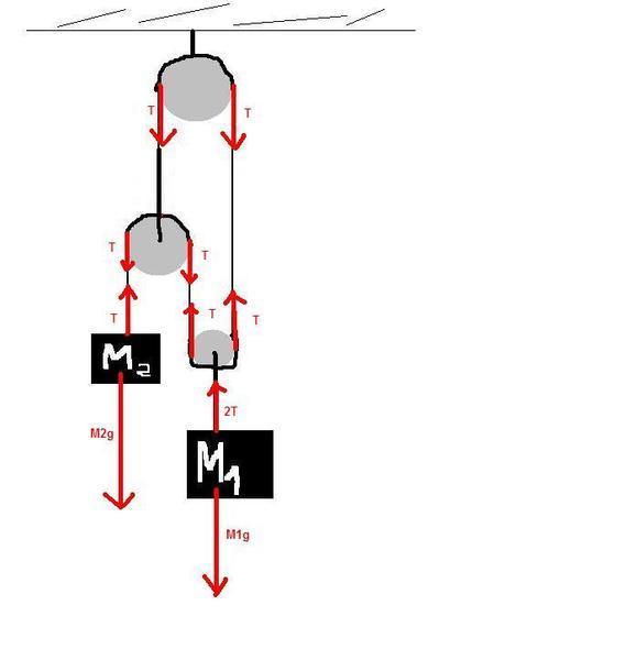

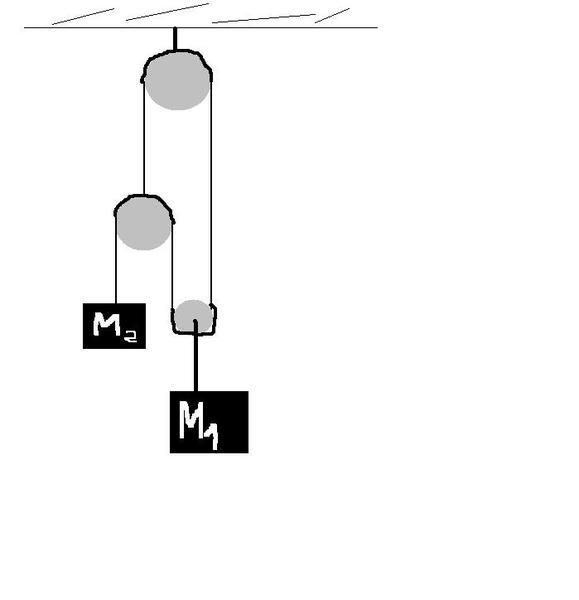

We must count the accelaration of mass two(M2). Pulleys and ropes are massless. I've made the free body diagram and I've got two equations and three unknowns.
Please help:)
I assume that you've applied Newton's 2nd law to both masses and that gave you your two equations. But what about the constraint equation that relates the accelerations of M1 and M2? That will be your third equation.
(To get additional help, show exactly what you've done so far.)
and two equations to those masses
but how i can write the third?

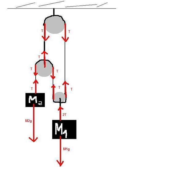

That's a good diagram showing the forces. What equations did you get?
ok
i understood it with those two tensions
and of course we can write equation for the center( downward) pulley
which is contradicted
This scheme is good but I still don't know how to solve this.

ok I wrote Newton's second law for the most left pulley:
0 * a = 2T-T
and for the rest massess if T=0 then accelaration of each mass is g, but they cannot move
is it correct?^^

Still waiting for you to show your two equations. (For m1 & m2.) Then we can worry about the third.
m2a2=m2g-T
m1a1=m1g-2T
OK. Now you must connect the two accelerations. How are they related? Imagine the system in motion--if m2 drops 1 m, what happens to m1?
Assume that the acceleration of m2 has magnitude "a" and is downward. Figure out the direction and magnitude of the acceleration of m1 in terms of "a".

No matter how you try to solve this, you'll still need to understand the constraint equation.
Since m1 and m2 are connected by a string, their accelerations are not independent. If you are having difficulty seeing how they relate, get a piece of string or a strip of paper and figure it out. (I'm serious.)
Here's an example of a constraint equation for the simple case of two masses hanging over a single pulley. If one mass goes up 1 m, then the other must go down 1 m. Thus, if one has acceleration +a, the other has acceleration -a. (Written as an equation, that would be: a1 = -a2.)
I've only know what heppens withe the string. In case when m1 goes up, m2 goes down and most left part of the sting gets +x, most right -0,5, that part of the rope which end is on the most left pulley gets +0,5x and the last one gets -x.
Since both lower pulleys are free to move, and you only get one constraint equation from the inextensible string, there's not enough information to solve this problem uniquely. Too many degrees of freedom. Interesting! (My bad, for suggesting otherwise--I didn't look at the diagram too closely at first.)

h2+2h1=const
so
a2+2a1=0
now we've got three equations and three unknowns(a1,a2,T)
a1=g(2m2-m1)/(4m2+m1)
menager31 said:
h2+2h1=const
how did you get that equation?
ok , so d1 is distance from m1 to horizontal plane and d2 from m2 to this plane.
when m2 goes down 1,5x then m1 goes up 0,75x
są now distances from the plane are:
h1=d1+0,75x
h2=d2-1,5x
h2+2h1=d2+2d1=const
