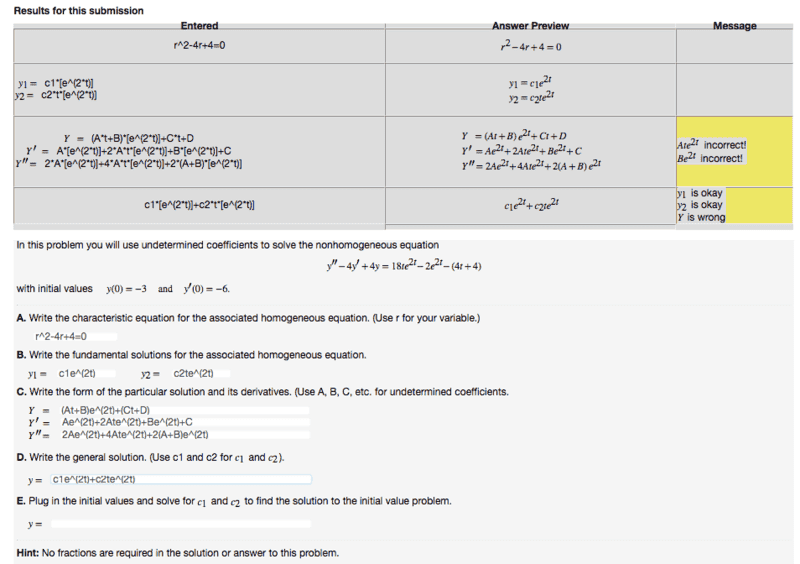

2nd order nonhomogeneous equation
(answers typed in in the pic)
for part c, if I can't put Ate^(2t) & Be^(2t), how is the form of particular equation like?
I have used Y=(At+B)e^(2t)+(Ct+D), because of the largest power of the equation.
Thank you.

The derivative of Be^(2t) should be 2Be^(2t),
Then you should have this for y':
Ae^(2t) + 2Ate^(2t) + 2Be^(2t) + C
Then your y'' will change as it is the derivative of y'.

other than my fault in deriving Y', my Y answer is also wrong
for Y, the comment is mentioned that the answer is without Ate^(2t) or Be^(2t), how can a particular equation without this two variables? thanks

question:
In this problem you will use undetermined coefficients to solve the nonhomogeneous equation y''-4y'+4y=18te^(2t)-2e^(2t)-(4t+4)
with initial values y(0)=-3 and y'(0)=-6
Write the form of the particular solution and its derivatives. (Use A, B, C, etc. for undetermined coefficients. Y=?, Y'=?, Y''=?
sorry for not typing out in advance, because the screenshot gave the questions, my attempts, and comments which I thought it would be more comprehensive.

ok, finally i made it A+Bt+Ce^(2t)t^2+De^(2t)t^3 which is correct... why and when should I multiply t/t^2 to the particular equation? thanks
Because it works! There is no better reason than that.
A hundred years ago some smart people figured out that we should do such things, and all we need to do is take their advice. Basically, that is what education is all about.
You might well ask how these things were discovered in the first place. The answer, I am afraid, is that people try many different methods; some of them fail and are a waste of time, while others work. What you see in print are only the results of the successes, not the hours of wasted time and mountains of scrap paper that went into the exploration.
