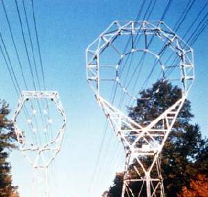

Careful, it is easy to get confused. We could invert to 6 phase power. Motors designed for that are better than 3 phase.
6 phase transmission has been explored. It is superior to 3 phase. That is better if the whole grid was 6 phase. But if 6 is only a small part of the grid, every interface to the 3 phase grid would need an expensive 6 to 3 transformer. Therefore 6 phase never got used in practice to my knowledge. Below are experimental 6-phase towers. The one on the right is double circuit 6P, not 12P.

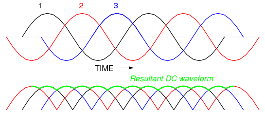

Well, say you have a transformer with 6 phases, the output could be rectified more smoothly by means of a 12-diode bridge.
As I calculate it, the ripple ( peak-to-peak without LC-filter ) in theory will be:
1 phase: 100%
3 phase: 13.4%
6 phase: 3.4%
But what I believe we are discussing in this thread is 6 phase inverters to supply 3 phase power. If you design the switching logic properly to select from 6 sources instead of 3, you can do a better job of approximating the 3 sinusoids. Any number of inverter phases >=3 can be used to generate 3 phase power. I hope I explained that clearly. I wish I had a graphical depiction of the waveforms, but I couldn't find it.

tim9000 said:
out of curiosity could you show that rough calculation?
A 3-phase full wave rectifier will have 6 DC pulses ( green curve ) per 360 electrical degrees. So 1 pulse will have a width = 360°/6 = 60° = 2*30°.
The upper peak value of a pulse = Vpeak* sin(90°) = Vpeak*1.
The lower peak value of a pulse = Vpeak* sin(90°-30°) = Vpeak* sin(60°) = Vpeak*0.866.
Thus a peak-to-peak ripple = Vpeak*(1 - 0.866) = 13.4%.
A 6-phase full wave rectifier will have 12 DC pulses per 360 electrical degrees . . . . . . . . . . = 3.4%
