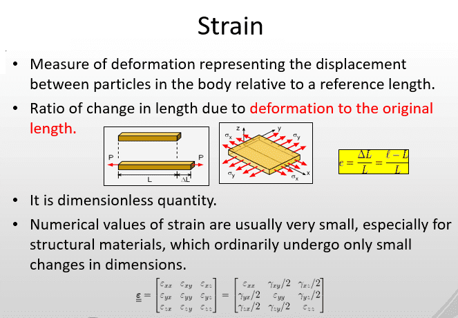

The discussion focuses on the derivation of strain components for a cubic structure, specifically addressing why the shear strain components εxy, εxz, εyx, εzx, εyz, and εzy are expressed as γ_xy / 2, γ_xz / 2, γ_yx / 2, γ_zx / 2, γ_yz / 2, and γ_zy / 2. The key takeaway is that these relationships arise from the definition of engineering shear strain, which is half the corresponding tensor component. The participants seek clarity on the mathematical reasoning behind this formulation.
