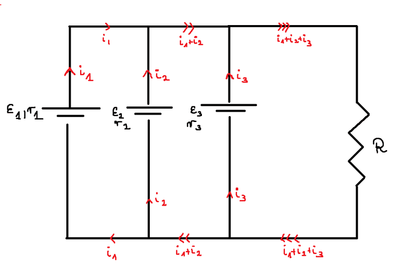

Solve this circuit:
a) Mark all currents
b) Write a system of equations allowing you to solve for the currents2. The attempt at a solution
Part a) in attachment.
Part b)
[tex] \epsilon_1 = i_1 r_1 + (i_1 + i_2 + i_3) R[/tex]
[tex]\epsilon_2 = i_2 r_2 + (i_1 + i_2 + i_3) R[/tex]
[tex]\epsilon_3 = i_3 r_3 + (i_1 + i_2 + i_3) R [/tex]
Is this solution valid?
  • Circuit schematic of three batteries in parallel with a resistor R on the right, with hand-drawn red current arrows labelled i1, i2, i3 and combined sums such as i1+i2 and i1+i2+i3 on the wires.

Looks right.
That will work. Your equations look fine.
