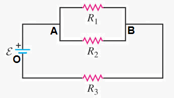

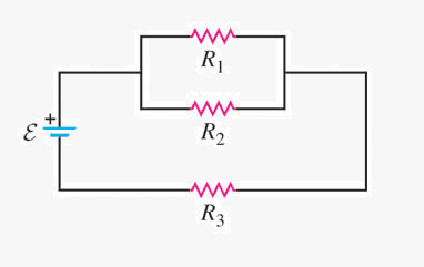

"Find ##R_2## and ##R_3##, assuming negligible resistance ##r=0\frac{V}{A}##."
Circuit schematic: battery with emf ε, polarity marked, in the left branch feeding R1 and R2 wired in parallel, then R3 in series on the return wire.
##R_1=6.1\frac{V}{A}##
##I_1=1.3A##
##I_3=4.8A##
##\epsilon = 24 V##
Voltage in parallel circuits: ##V_1=V_2## or ##I_1R_1=I_2R_2##
Total voltage: ##\epsilon = I_1R_1+I_2R_2+I_3R_3##
##I_3=I_1+I_2##
##I_2=I_3-I_1=3.5 A##
##R_2=\frac{I_1}{I_2}R_1=2.265\frac{V}{A}##
##R_3=\frac{1}{I_3}(\epsilon -I_1R_1+I_2R_2)=1.7\frac{V}{A}##
I'm new to circuits, so if anyone would like to care to tell me where I went wrong, that would be much appreciated. Thank you.

The last line is wrong. It would be true if all resistors were connected in series.

Wrong. What is the voltage across R3?
It's not ##V_3=I_3R_3##? In any case, could I not replace the two parallel resistors by an equivalent resistor so that everything is in series?
##\frac{1}{R_{eq}}=\frac{1}{R_1}+\frac{1}{R_2}=\frac{R_2+R_1}{R_1R_2}##
So ##R_{eq}=\frac{R_1R_2}{R_2+R_1}##. And now we have...
##\epsilon = I_3(\frac{R_1R_2}{R_2+R_1}+R_3)## or ##R_3=\frac{\epsilon}{I_3}-\frac{R_1R_2}{R_2+R_1}##

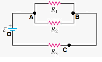

Sorry, I forgot to show point C.
Circuit schematic: battery with emf labelled script E and terminal O on the left, nodes A and B at the ends of a parallel pair of resistors R1 (upper) and R2 (lower), and resistor R3 in series along the bottom with node C between R3 and B's return wire.
I asked the potentials at A, B, C, with respect to point O. Can you calculate the numerical value of UB? What is UC then? What is the potential difference across R3 ?

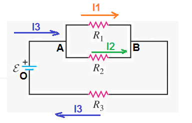

Sorry, I1 was 1.3 instead of 1.6. So the voltage across both R1 and R2 is 7.93 V.
What is the direction of the current through R1?
Well, it goes from positive to negative, so the negative direction? Wait, it starts from ##0V## then goes to ##7.93V##, so the positive direction.
So relative to ##O##, ##U_A=0V##, and ##U_B=U_C=7.93V##, some point after the third resistor is ##U_3=16.07V##, and at the emf, ##U_{emf}=24V##, I think.
Yes, the current flows from A to B.
Circuit schematic: a battery with terminals labelled + and O on the left, with R1 and R2 in parallel between nodes A and B, and R3 in series on the bottom branch. Currents I1, I2 and I3 are marked by arrows.
Point A is connected to the positive terminal of the battery, it is at 24 V with respect to the negative terminal. The potential drops across R1 in the direction of the current. If A is at 24 V and the potential drops by 7.93 V across R1, what is the potential at point B?
What is the potential difference across R3?
Let's see... ##U_B=16.07V##, and I guess ##U_C=7.93V##. So ##U_A-U_B-U_C=0##?
Yes, UB=16.07 V with respect to O. B and C are connected by a wire of zero resistance, so they are at the same potential: UC=16.07 V. What is the potential difference across R3?
Try to understand that UA, UB, UC are potential differences. NO sense to add them. The potential differences along a loop add up to zero, not the potentials.
