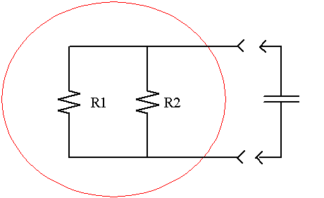

Would you say that the resistors are in series or in parallel?

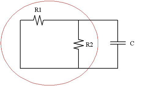

well this I think is my problem, and perhaps after you help me out here I will be good to go. I thought that R2 and C are in parallel, but R1 and R2C are in series.
So perhaps I just answered my own question, the effective resistance is therefore in series? But the current still undergoes a junction, but then again capacitor holds no resistance... hm.
Let me redraw the circuit one more time. Are the resistors in series or in parallel? What will the capacitor see?
lol I feel like we are beating this to death here, but still so foggy :(
The resisters are now in parallel, the capacitor will have its current split across both?
Yes :smile:
Note that all the connections are still the same -- it's not a different circuit. Nothing changed but the way the circuit was drawn in order to make the relationship between R1 and R2 more obvious.
Yes :smile:
So the equivalent resistance that the capacitor "sees" is R1 in parallel with R2. That's the resistance that will go into the time constant.
