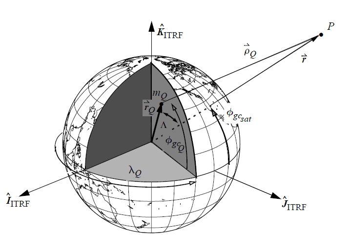

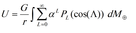

i was reading a book on astrodynamics and was trying to understand the mathematical treatment of the Earth gravitational potential . i kinda understand the main idea , after reaching the following equation of the potential in terms of the Legendre polynomials :
##\alpha = r_{Q}/r##
i am really interested in the geometrical interpretation of this equation which is known as MacCullagh’s method , the 1st , 2nd and the third expansion terms was some how understandable in which they some how determine the moment of inertia and different mass distribution contribution to the non sphereicity , but i am curious abut the 4th term :
it some how seems like we start the series with the regular spherical potential and each successive term held some kind a contribution to the non sphericity so every term should have a physical meaning , right! , what this term mean is it also some kind of a fancy combination of moment of inertial around some point or something ?!

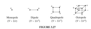

It might be worth considering multipole moments in electrostatics.
A point charge q has a potential that falls off as 1/r.
Take two point charges q and -q, separated by a distance d, but still centered at the origin... an electric dipole.
How does the potential behave far away, at large r?
Since the net charge is zero, there is no monopole term...
This follows by superposition...
far away, the opposite sign potentials from these slightly displaced charges almost cancel.
Now take two identical dipoles and flip one and displace them slightly...
so it looks like a square centered at the origin, with alternating charges as one walks around the square.
The dipole term is also zero.
Keep going.
Here's a figure from Griffiths Introduction to Electrodynamics.
