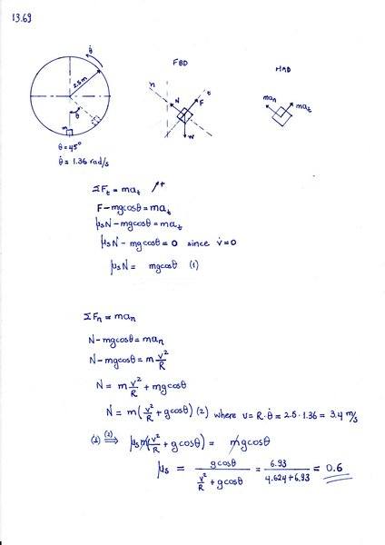

13.69 A packege of mass m is placed inside a drum that rotates in the vertical plane
at the constant angular speed ##\dot {θ} = 1.36 rad/s##. If the package reaches the position
θ = 45deg before slipping, determine the static coefficient of friction between the
package and the drum
Can you check my solution?
I like that you wrote your algebra in terms of a generic angle θ, but in doing so you opted for the wrong trig function somehwre. There should be a cosine in one place and a sine in the other. But since θ happens to be 45° this made no difference and you got the right answer.
