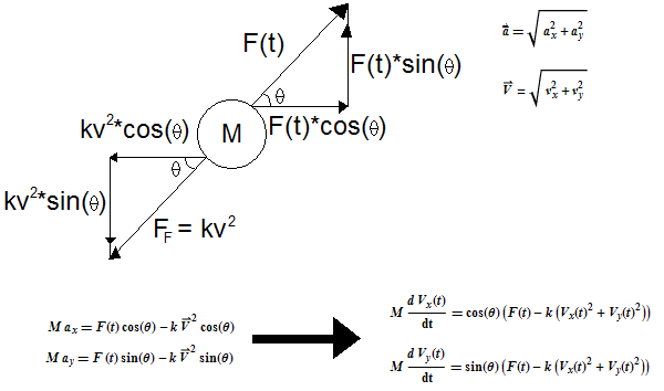

What I've attempted to do here is to model the motion of a 2D particle with some force F(t) being applied. I was told in my physics class that the force of friction is proportional to velocity squared or Force-of-friction==k*v[tex]^{2}[/tex].
I assumed that the friction force would be pushing the opposite direction as F(t).
I then broke the acceleration, friction, and the applied force into horizontal and vertical components and used Newtons second law to equate them leading to the pair of equations below the diagram. These can then be transformed into a pair of differential equations which I'm having a heck of a time trying to solve.
If anyone could tell me whether or not I'm modeling this situation correctly or if I've gone horribly wrong somewhere that'd be great, I would also appreciate any help I could get solving these differential equations in general for Vx(t) and Vy(t) (if they are, in fact, correct).
Welcome to PF,
Why do you model the frictional force to be going in the opposite direction as F(t)...?
The normal thing would be to have the frictional force point in the opposite direction of the motion of the particle, that is
[tex] \underline{K}= - k |v| \underline{v}[/tex]
I didn't check the rest of your derivation. I want to make sure first that this somewhat strange frictional force is really what you want to do:smile:

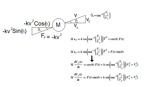

Okay, I thought that assumption was off. Could you give me any ideas as to how I would go about fixing my current model? My goal is to be able to find out what the motion of a particle undergoing this kind of friction while a force is being applied is like.
EDIT: Okay I've started figuring stuff out, Since the frictional forces angle will depend on the angle of the velocity and the horizontal and vertical components of velocity are Vx and Vy respectively, we know the angle must be Tan[tex]^{-1}[/tex](Vy/Vx) This should allow me to make a different set of correct equations based on the principle above.
You can proceed as before.
It might be easier not to use angels as you did.
Let [itex]F(t)=(F_x(t),F_y(t))[/itex]. The position of the particle at time t is (x(t),y(t)). The frictional force is [itex]K(t)=-k |\underline{v}| \underline v[/itex]. (What I wrote above was cubic in v, sorry) Then you have
[tex] M \ddot x(t) = F_x(t) - k \sqrt{\dot x^2(t)+\dot y^2(t)}\dot x(t)[/tex]
And similar for y(t). Solving these equation is of course a different matter. What kind of F(t) are you thinking of..?
Okay, so I've found the angle which the frictional force will always have (Tan [tex]^{-1}[/tex](Vy/Vx)) in order to separate it into components and derive a system of differential equations. I'm still applying a force F[t] at angle theta to the particle of mass M and have separated that force into components and accounted for it. The resulting system of differential equations is pretty scary, as usual any help solving, or pointers, or pointing out of mistakes I have made would be appreciated.
Ok that's equivalent to what I wrote.
You should check some trigonometric identies to get rid of the [itex]\cos \arctan(\dots)[/itex] and [itex]\sin \arctan(\dots)[/itex].
I continue with my expression from above (it's the same as yours)
[tex]M \ddot x(t) = F_x(t) - k \sqrt{\dot x^2(t)+\dot y^2(t)}\dot x(t) \quad (1)[/tex]
[tex]M \ddot y(t) = F_y(t) - k \sqrt{\dot x^2(t)+\dot y^2(t)}\dot y(t)\quad (2)[/tex]
First try to solve for [itex]\dot y(t)[/itex]:
[tex]F_x(t)-M \ddot x(t) = k \sqrt{\dot x^2(t)+\dot y^2(t)}\dot x(t)[/tex]
[tex]F_y(t) -M \ddot y(t) = k \sqrt{\dot x^2(t)+\dot y^2(t)}\dot y(t)[/tex]
Divide the second by this first..
[tex]\frac{F_y(t) -M \ddot y(t) }{F_x(t)-M \ddot x(t)} = \frac{\dot y(t)}{\dot x(t)}[/tex]
So [tex]\dot x(t)\frac{F_y(t) -M \ddot y(t) }{F_x(t)-M \ddot x(t)} = \dot y(t)[/tex]
For [itex]\ddot y(t)[/itex] you can insert (2). Then it takes some algebra to solve for [itex]\dot y(t)[/itex]. This result you plug into (1) which then only involes [itex]\dot x(t),\,\ddot x(t)[/itex]. If you're lucky you don't end up with something being identically true. ( I didn't try :smile:) Then we can think about how to solve this resulting (uncoupled) ODE.
