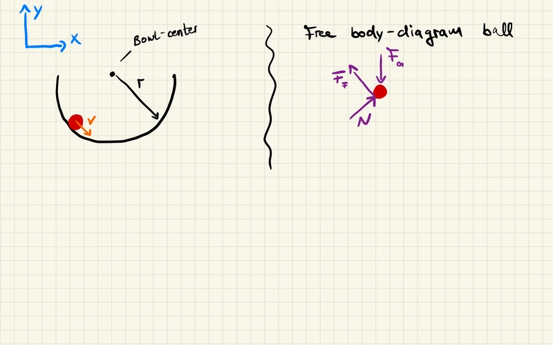

Consider a 2D circular bowl with a point mass moving inside, as shown in the picture. Assume that the normal force N acting on the mass is already known and keeps the mass constrained to the curved surface of the bowl.
I want to model Coulomb friction in this system so that, for example, if I release the mass on one side of the bowl, it loses energy over time and does not reach the opposite edge.
My initial idea is to use a friction model like this:
F = -mu * N * sgn(vel_rel)
where mu is the friction coefficient and v_rel is the relative velocity between the mass and the bowl.
However, since the bowl has a curved surface, should I instead project the relative velocity onto the local tangent of the bowl's surface where the ball is in contact before calculating the friction?
What is the correct way to include Coulomb friction in this scenario?

Here I need to model the Frictional force in cartesian coordinates. I already set up the lagrangian and derived the expression for the normalforce. But the Friction in the lagrangian appears on the right hand side of the equation in the non conservative force vector. So I have to set up this seperatly

Okay I'll try to rephrase this. In my model the ball is described in cartesian coordinates. So it has a acceleration in x and y. Therefore I have two differential equations in the form
ball_mass * x_ddot = ...
ball_mass * y_ddot = ...
So my non-conservative force vector Q also has 2 components, one in x and one in y direction. My initial idea was to just set the Q vector to friction_coefficient * normalforce in both components. But now imagine the ball is in the lowest point in the bowl and has some velocity. at this point the frictional force should only act in x direction not in y. therefore I think I need to project the friction to the local tangent but am not sure how to do that
The friction vector is perpendicular to the normal force vector. But you are just scaling the normal force vector with the friction_coefficient?
The direction of friction on the ball is opposite to velocity of ball relative to bowl. This is already parallel to the local tangential plane.

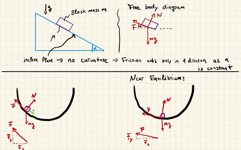

in the upper example there is no curvature. in the bowl system the contact surface has a curvature. this means in the 2 drawn examples that the frictional force acts in different directions. so the magnitude in y direction for example is in the left example bigger then in the right example. when the ball is in equilibrium position the friction in y direction becomes zero. Do you see my point now?
Sure, because relative velocity is in different directions, and kinetic friction is in the opposite direction of relative velocity.
No.
No.
okay so you think these equations are correct?
F_x^{\text{friction}} = -\mu \cdot \lambda \cdot \frac{\dot{x}_{\text{rel}}}{\sqrt{\dot{x}_{\text{rel}}^2 + \dot{y}_{\text{rel}}^2}}
F_y^{\text{friction}} = -\mu \cdot \lambda \cdot \frac{\dot{y}_{\text{rel}}}{\sqrt{\dot{x}_{\text{rel}}^2 + \dot{y}_{\text{rel}}^2}}
Yes, for the simplest model of kinetic friction. It doesn't include static friction and the transition between the two types.
