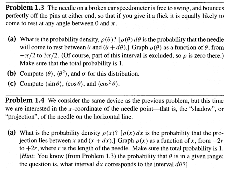

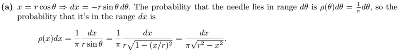

I can't understand the solution to Problem 1.4(a). The solution is the following:
What puzzles me is that ρ(θ)dθ=ρ(x)dx ? Why are they equal?

Now he wants the probability for the projection ##x##, which is in the range ##x \in [-r,r]##. You have to remember that this is a probability distribution, i.e., you must have
$$|\mathrm{d} \theta| P(\theta) = |\mathrm{d} x| \tilde{P}(x).$$
Now you have
$$|\mathrm{d} x|=r \sin \theta=\sqrt{r^2-x^2}.$$
Thus we have
$$\tilde{P}(x) = \left |\frac{\mathrm{d} \theta}{\mathrm{d} x} \right| P(\theta)=\frac{1}{\pi \sqrt{r^2-x^2}}.$$

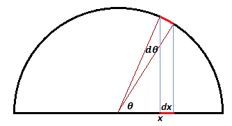

It helps me to think of it this way (similar to PeroK's reply). The only way for the shadow to be between x and x + dx is for the pointer to be between the corresponding θ and θ + dθ as shown below (and vice versa). So, the probability that the shadow is between x and x + dx equals the probability that the pointer is between the corresponding values θ and θ + dθ. The values of dθ and dx that correspond to each other are given by dx = -r sinθ dθ
