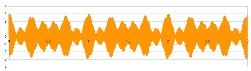

The question I am asking is not that difficult. Look at this picture of two superimposed frequencies producing a beat:
https://en.wikipedia.org/wiki/File:Beating_Frequency.svg
In terms of the picture, what is the period of one beat?

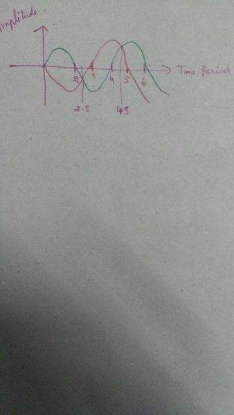

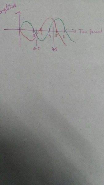

harini07 said:
I have included a rough graph.sorry for it's incoherence.i know it's too poorly picturised :/ but @haruspex (sorry if I spelt your name incorrectly) beg you please explain me how to do it at least now :(
And in that graph that I have drawn, it's clear that first they meet at 2.5 seconds and then at 4.5 I.e. again after 2.5 seconds.correct me if I am wrong? But how could I relate this to get the answer to the question that I've posted!

You appear to have drawn one of period 4 and one of period 5. They started 180 out of phase (one is going up and the other down).
At the 4.5 mark, they are not both back where they started. At a point where they have both completed a whole number of cycles, each should continue exactly as it did from time 0, i.e. both at the x axis, with the red line going down and the other up.
Mark 12 equal intervals on the x axis. Have both curves rising from the origin. The period 2 curve goes down through the x-axis at t=2, 6 and 10, and up through it at 0, 4 and 8. The period 3 goes down through the x-axis at 3 and 9, and up through it at 0, 6 and 12.

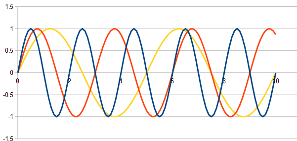

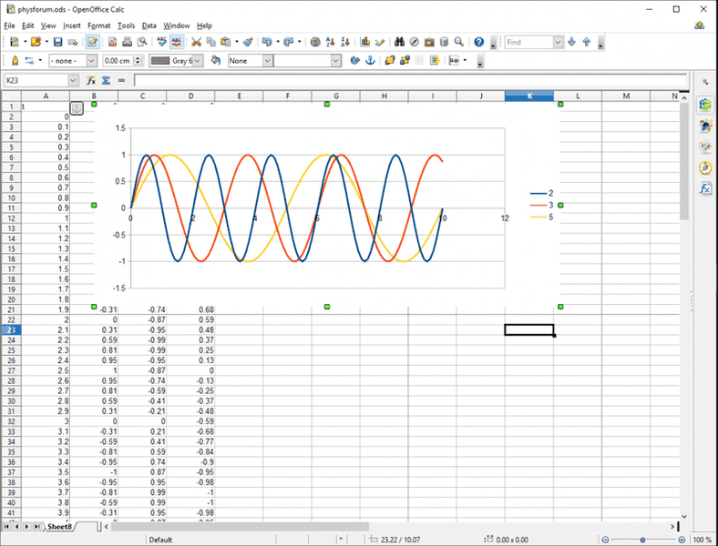

Here are three sine waves of the same amplitude, all starting in phase. Can you figure out what the three periods are?
Can you find the time at which a pair of them are both back to their starting state? (There are two such pairs.)
Can you see how the time for two to get back into phase relates to their individual periods?
When will all three be back in phase?

so the period of blue wave is 2 (say n1) and the period of orange wave is 3 (n2), they are back at their original position at T=6s. (n1xn2).they will be again in phase 2(n1xn2) i.e T=12s and T=18s? but what about the third yellow wave? it's time period is T=5s and it doesn't seem to be in phase with the two of them at any point of time. now i would like you to correct me if I'm wrong. PS: thanks for the graph.it's really helpful! :)
It does get back into phase with one of them - just. But my graph only goes for 10 seconds. Maybe some resynchronisations take longer.
Try thinking of the periods of the waves as rods of different lengths, 2, 3 and 5. What is the shortest length that can be made entirely of rods length 3 or entirely of rods length 5?
