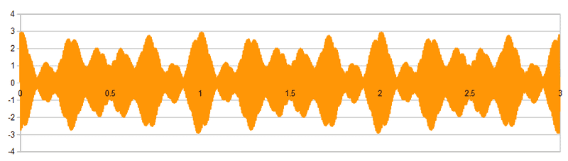

But here's what it actually looks like:
I challenge anyone to decide where the beats are in that mess. The absolute max amplitudes are at 1 second intervals (indeed, it repeats at 1 second intervals, which should be obvious from the given frequencies), but there are lots of other local maxima at uneven spacings, some almost as large as the absolute maxima.
Maybe the reason I cannot find anything online about beats from three or more sources is that it is not well-defined.

the answer is supposed to be 12.
That is demonstrably false. The pattern I posted repeats every 1 second ( which you can prove using the LCM of the three periods 1/3, 1/4, 1/7 of the three pairwise beat frequencies). Within that, you can see there are 7 more-or-less evenly spaced bulges each second, so you could make a case for the answer 7. One bulge is a lot smaller than the other 6, but if we discount that then the spacing becomes rather uneven, so no longer qualifies as a "beat".

As I wrote in post 35, you can use the LCMs of the three pairwise beat frequencies to show that the pattern repeats after 1 second, but that is not the same as saying it has a beat frequency of 1 second. Beats are perceptual. If you were to hear the pattern of pulses depicted in post #33, I don't think you'd say it had a beat frequency of 1 second.

As you can see from the image I posted at #33, the book answer is simply wrong. The question is why.
First, as I wrote at the outset, we need a definition of a beat. Originally it was certainly a matter of perception, and implied a regular pulse of sound. In the usual treatment of two waves, that is what you get. But three waves will not give a nice regular pulse.
The book appears to be defining it as the rate of local peaks in the combination of the three pairwise beats. From a theoretical perspective that feels odd. Why should it be broken into those two stages? We could more reasonably ask how many peaks there are in the amplitude altogether, but then we would answer 200x203x207.
From an auditory perspective it fails because some of these 11 (not 12) overlap so significantly you would not hear them as separate.

Well, post #33 shows, arguably, 7 pulses each second, so not all 11 overlap with others.
harini07 said:
there is no regular pulse which can be the ultimate answer to this question but simply there are set of pulses that get repeated over the period of time, right?
Right.
