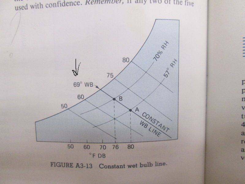

this the second related picture

mech-eng said:
There is wet-bulb temperature of 69 centigrade in the picture which I cannot understand how it is placed there and what is the relation between it and saturation line (RH of % 100)
Isn't it 69 degF not C ?
It'd be placed vertically above the 69 on horizontal axis
because
at 100% humidity , wet bulb and dry bulb are the same ? And at any other humidity there's wet bulb depression ?
Remember what's going on on that psychrometer - moisture is evaporating, cooling the bulb. They're plotting that depression.
