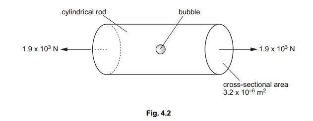

A cylindrical rod has a spherical bubble in it. as illustrated in figure 4.2 (in the attachments)
The rod has a cross sectional area of 3.2 x 10^-6 m^2 and is stretched by forces of magnitude 1.9 x 10^3 N.
The maximum Stress that the cylinder can take is 9.5 x 10^8 Pascals.
Stress = Force/ Cross sectional area
Basically what I did was say:
Maximum stress = Force applied/Area
9.5 x 10^8 = 1.9 x 10^3 / Minimum area
Minimum area = 2 x 10^-6 m^2
So the maximum Cross sectional area of a rod is 2 x 10^-6 m^2
The right answer was on the other hand to do all this + subtract new area from old area so it becomes (3.2 - 2) x 10^-6 = 1.2 x 10^-6
This is the part I don't understand. Shouldn't the maximum cross section of the ball be the area of the new cylinder so that if it is more then the cylinder breaks?

Hi Farouk,
I'd like to help with this, but I don't see the actual question that is being asked. What are they asking you to find?
Chet
Sorry forgot to include it :)). It was: what is the maximum cross section of the ball.
Its really vague what is asked here :/
The bubble can't support any stress, so all the stress must be carried by the 2x10-6 m2 of rod material surrounding the bubble. That leaves 1.2x10-6 m2 cross sectional area available for the bubble.
