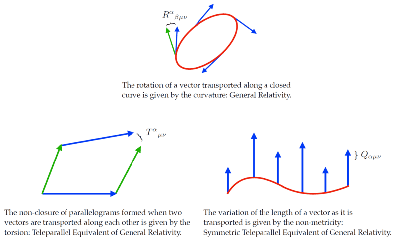

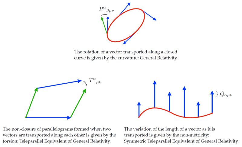

Actually, there are no constraints. In any 4D spacetime with a symmetric metric ##g##, the most general connection ##\Gamma## decomposes in a coordinate basis as:$$\Gamma{}^{\alpha}{}_{\mu\nu}=\left\{ _{\mu\nu}^{\alpha}\right\} +\frac{1}{2}\left(T^{\alpha}{}_{\mu\nu}+T_{\mu}{}^{\alpha}{}_{\nu}+T_{\nu}{}^{\alpha}{}_{\mu}\right)+\frac{1}{2}\left(Q^{\alpha}{}_{\mu\nu}-Q_{\mu}{}^{\alpha}{}_{\nu}-Q_{\nu}{}^{\alpha}{}_{\mu}\right)\qquad\text{(General connection; 64 components)}$$with:$$\left\{ _{\mu\nu}^{\alpha}\right\} \equiv\frac{1}{2}g^{\alpha\lambda}\left(g_{\lambda\mu,\nu}+g_{\lambda\nu,\mu}-g_{\mu\nu,\lambda}\right)\qquad\text{(Levi-Civita/Christoffel})$$and where:$$g_{\mu\nu}=g_{\nu\mu}\qquad\text{(Metric tensor; 10 components)}$$$$T^{\alpha}{}_{\mu\nu}\equiv\Gamma{}^{\alpha}{}_{\mu\nu}-\Gamma{}^{\alpha}{}_{\nu\mu}\qquad\text{(Torsion tensor; 24 components)}$$$$Q_{\alpha\mu\nu}\equiv\nabla_{\alpha}g_{\mu\nu}\qquad\text{(Nonmetricity tensor; 40 components)}$$Note that all 74 combined components of the metric and general connection ##\left\{ g,\Gamma\right\} ## are expressed entirely in terms of the 3 tensor fields ##\left\{ g,T,Q\right\} ##. These fields may in general be freely specified (as long as the metric remains invertible) without encountering any inconsistencies or constraints to be satisfied. Of course, torsion and nonmetricity do lead to geometric differences compared to Riemannian spacetimes: parallelograms don't close and and vector lengths change under parallel transport:
(from https://www.mdpi.com/2218-1997/5/7/173/pdf )
But these differences can be useful for physics: one important historical example is the invention of gauge theory by Weyl in 1918 that is founded on nonmetricity, where he made ##Q_{\alpha\mu\nu}=A_{\alpha}g_{\mu\nu}## a function of the the electromagnetic vector potential ##A_{\alpha}##.

haushofer said:
Two reasons I can think of:
- ##\nabla_{\rho} g_{\mu\nu}=0## is the covariantization of the condition ##\partial_{\rho} \eta_{\mu\nu}=0## on the Minkowski metric in Cartesian coordinates.
- Physical observables depend on inner products, e.g. the energy of a particle. Without metric compatibility, these observables would depend on the specific path (the "history") taken, which in a lot of cases is not desirable.
Thanks a lot:
Yes, if ’observables would depend on the specific path (the "history") taken, which in a lot of cases is not desirable‘。The property of depending on the specific path is path dependent.
As a scalar, if it's movement is path dependent, it perhaps a result of vector field with non-zero curl. If a vector's movement is path dependent, it depends on a connection field whose curvature is not zero.
And I also think that the metric compatibility eliminate some path dependence of a vector's movement in the space. So I think the metric compatibility is a constraint on the connection.
but I don't know how.
renormalize said:
Getting the metric from the general connection requires integrating an involved system of first-order partial differential equations. But differentiation is much easier than integration! So instead, go the in opposite direction and consider the general connection ##\Gamma## to be output from the given input tensors ##\left\{ g,T,Q\right\} ##:$$\left\{ g,T,Q\right\} \Rightarrow\Gamma,\quad\left\{ g,0,0\right\} \Rightarrow\Gamma',\quad\left\{ g,T,0\right\} \Rightarrow\Gamma'',\quad\left\{ g,0,Q\right\} \Rightarrow\Gamma''',\quad\text{etc.}$$The differences between the various output connections can then be simply read-off from the first equation in post #15. Also note that we are free to set ##g## to be the flat metric ##\eta## and build connections strictly from the torsion ##T## and/or nonmetricity ##Q##. Such connections give rise to various teleparallel (but flat) analogs of curved Riemannian spacetime.
I still have a question.
In GR, if we start from a flat metric ##\eta_{\mu\nu}##, we will get a zero connection, then a zero curvature. But if we start from a zero-curvature connection. then it is not necessary to demand that the connection must be zero, then if we using such connection, from the metric compatibility equation, then the metric compatible to the connection usually is not ##\eta_{\mu\nu}##, then I want to know that from a zero-curvature connection, what are the three parts of the general connection. and if the corresponding metric must be ##\eta_{\mu\nu}##.
Starting from the flat spacetime metric ##\eta{_{\mu\nu}}## (in cartesian coordinates) gives a zero Levi-Civita/Christoffel symbol, ##\left\{ _{\mu\nu}^{\alpha}\right\}=0##, resulting in vanishing curvature ##R^{\alpha}{}_{\beta\mu\nu}=0##. But even when spacetime is flat it can still carry a general connection ##\Gamma## containing torsion ##T## and/or nonmetricity ##Q## (see again the first equation of post #15). So the most general connection on flat spacetime in cartesian coordinates will be ##\Gamma{}^{\alpha}{}_{\mu\nu}=\frac{1}{2}\left(T^{\alpha}{}_{\mu\nu}+T_{\mu}{}^{\alpha}{}_{\nu}+T_{\nu}{}^{\alpha}{}_{\mu}\right)+\frac{1}{2}\left(Q^{\alpha}{}_{\mu\nu}-Q_{\mu}{}^{\alpha}{}_{\nu}-Q_{\nu}{}^{\alpha}{}_{\mu}\right)##. And the flat metric ##\eta## is perfectly consistent with this general connection ##\Gamma## by its very construction, with ##\nabla_{\alpha}\eta_{\mu\nu}=Q_{\alpha\mu\nu}## (metric-noncompatible for ##Q\neq0##, metric-compatible otherwise). So to answer your question: yes, in flat spacetime with a general connection ##\Gamma##, the corresponding metric must be ##\eta{_{\mu\nu}}##. How could it be otherwise? Flat spacetime is equivalent to a flat metric!
Thanks for your reply:
Perhaps there is some difference about how to comprehend metric compatible. In my opinion, metric ##g## is compatible with ##\Gamma## just means that if we put ##g## and ##\Gamma## into metric compatibility equation. the equation is true.
So I think that it is possilbe that there exist a zero-curvature connection and a metric which is not ##\eta## can make metric compatibility equation work.
If I don't misunderstand your opinion. a general connection with zero Levi-Civita connection is compatible with flat metric ##\eta##, To me this means that if we put the general connection and ##\eta## into the metric compatibility equation, the equation is true. Can you prove it?
