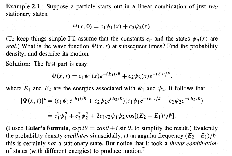

Okay, well I am almost good, but one part I haven't figured out.
I get the answer to be (using Euler's Identity)
$$c_{1}^{2} \psi_{1}^{2} + 2c_{1}c_{2} \psi_{1} \psi_{2} \Big [cos \Big ( \frac {E_{2}t}{\hbar} - \frac {E_{1}t}{\hbar} \Big ) + i \hspace {0.02 in} sin \Big ( \frac {E_{2}t}{\hbar} - \frac {E_{1}t}{\hbar} \Big ) \Big ] + c_{2}^{2} \psi_{2}^{2} $$
However, the answer has the term with ##i \hspace {0.02 in} sin (\theta)## missing. How did that term get cancelled?
I'll just cut to the chase and post the example/solution, how was the term with the imaginary number and sine cancelled??
First off, and I know it's always bold to accuse a textbook of making errors, but the author seems to have missed a ##t## in the ##c_2## exponentials on the penultimate line.
To see the logic, explicitly multiply out the cross terms, remembering the rules for multiplying powers that we discussed earlier. Then use Euler's identity as given in the book, and remember that ##cos(\theta) = cos(-\theta)## and ##sin(\theta) = -sin(-\theta)##.
Does that mean my solution is correct?
No the sine terms should still cancel.
