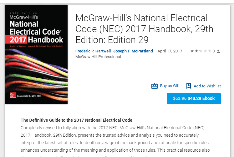

I am not familiar with the home AC Mains electrical codes in your country. In the US, Neutral and Earth Ground are connected by Code at the home distribution panel, so there is very little voltage developed between Neutral and Earth Ground within a home. (Safety Note -- that assumes that the home has been wired to Code, and there are no faults in the system -- it is always a bad idea to use a human as a "shock/fault detector"; I hope you realize that.)
Can you post the relevant Code regulations for the country where you are teaching these students please? In the US, the Code requirements are published in the NEC.
