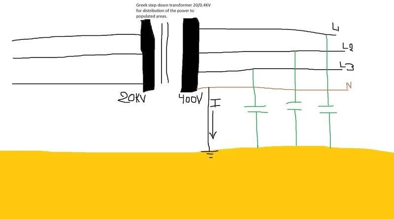

This is a topic that almost no one can actually explain from what I found on the internet. This answer https://physics.stackexchange.com/q...ent-ac-require-a-complete-circuit/74999#74999 is the closest I found so far.
The idea is how the grounded neutral completes the circuit by closing a LOOP between the Neutral-Ground and another part of the circuit (Where the "I" current is located in the picture).
Question 1) People from my university told me that the current does not return back to the circuit but you can imagine that it "Gets Absorbed" by the earth. Is that true and how does it happen? How does a voltage drop between the Neutral and Earth, is formed so current can flow towards the earth?
Question 2) I tried to explain it by taking into consideration the capacitance that is formed between the lines and the ground. If you see it like that, then there are multiple loops between the Grounded Neutral and each phase. But is this true? If this was true then I imagine the following current flow which is not correct:
So what is going on?

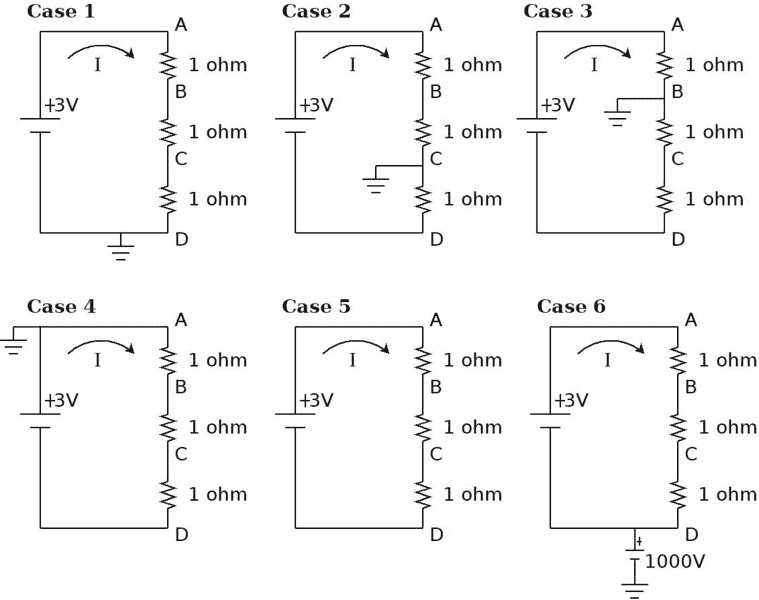

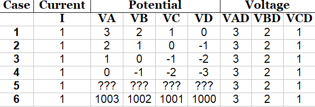

Second, as you can see in the graphic below, current does not flow through the ground. In normal circumstances, it doesn't matter where you put the ground in the circuit. The currents, and the voltages measured by a voltmeter between any two points in the circuit, remain unchanged. The concept of electric potential at one point, is related to voltage, but is not identical to voltage, and that is probably the source of your confusion.

@babaliaris From what I see you have drawn everything correctly, that same connection is also used here where I live.
Normally the current flows only between the 3 phases and in some cases (single phase) back through the neutral.
The neutral is grounded and the local substation and not at the power plant, because HV power is transmitted only using phases. Then if you have a good ground connection at your house and in case your phase manages to apply it's potential to any of the grounded parts of your appliances then a current flows through the ground , but not all of that current goes back via earth to the local substation.
In fact I don't know but I would guess very little?
Most of it (since it's AC) charges and discharges the ground capacitance which is large.The reason I say that very little if any ground fault current actually makes from your home back to the local substation is because you can calculate current with Ohm's law, and if one measured the resistance between a house grounding point and the local substation the resistance would be so large in many places that no current could flow there realistically.

And yes I think you got it correctly, the ground is like a giant capacitor and the local home grounding rods are just pins that attach the house to the capacitor plate.
The other pins and the other side are at the local substation.
But here's the trick, since earth is so large and AC wires cover a long distance, even if your local substation wouldn't have a ground connection you would still have a ground current to earth if you for example attached a phase wire to ground.
The HV transmission phase wires have no direct connection to ground and yet due to their large length and surface area they form a huge capacitor towards ground. This is the major factor that causes line capacitance.

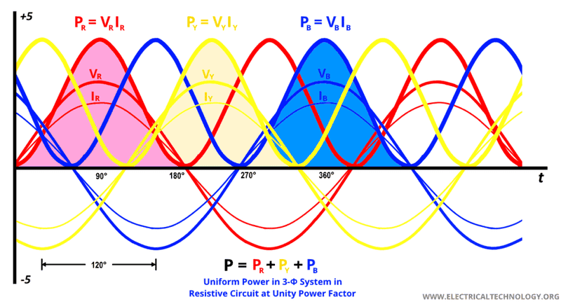

In your diagram, the power current is supplied and returned in the three 3-phase wires. The three phase system needs no neutral wire. I think you are confusing the split single-phase residential wiring with 3-phase.
This graphic may help. The red, yellow, blue curves are the power flows on the three 3-phase wires. At any point in time, they add up to zero. In other words, the power is supplied and returned on those 3 wires every instant. That's why no neutral is needed. I urge you to verify that out yourself on the graphic. Choose a few time instants and add up the three.
A small amount of leakage current might go to ground, but this is negligible compared to the current carrying the power. During abnormal cases, larger currents may go to ground, but we're focusing here on the normal case.
