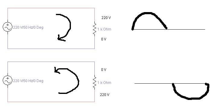

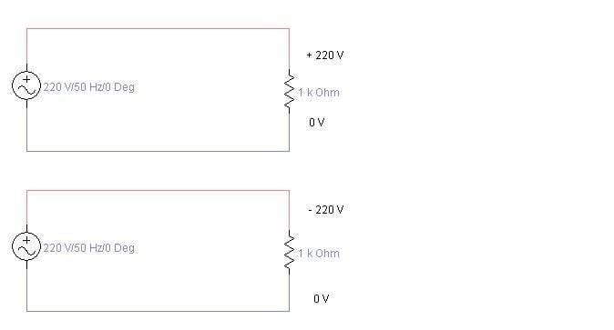

The first picture is a regular ac circuit, where the voltage alternates between 240V/0V in one of the wire. The second picture is a live/hot & neutral ac circuit. Are these 2 different type of circuits? And if I connect the top circuit to the ground which makes it neutral (just like the pic in the bottom), does the alternating voltage suddeny changes from +240/-240?

My question is what really is the difference between these 2 pictures

4. What do you mean by "alternating voltage changes from +240/-240"? AC voltage constantly changes polarity; in your schematic it's changing at the rate of 50 cycles per second.
As far as I can tell your diagrams just show the same circuit each time (220 Vac/50 Hz generator connected across a 1 kilo-ohm resistor); you're just showing the positive and negative cycles.
No, I mean for a live & neutral circuit, the diagram on the top is not suitable as one of the wire's is not kept constant.

There may be two possibility of AC,
1)
On first half cycle one wire is at max potential while other is at 0 potential but on next half cycle the wire which was at max potential will be at 0 potential while other which was at 0 potential will be at max potential as shown in figure below,

2)
On first half cycle one wire will be at positive max potential and on next half cycle this wire will be at negative max potential while the other wire always remain at 0 potential. As shown in figure below,

Can anyone tell me which concept is correct?

@Kevin J , I think you are being fooled by the way we use words.
Voltage is always defined as the difference in potential between two points. You need two wire leads to use a voltmeter. Depending on where you put the two leads in a circuit, you can measure many differences.
There is a dual purpose for the ground symbol in a circuit.
  1. It is placed at an arbitrary place in a circuit. The meaning is that we arbitrarily define that point as zero voltage. Then differences in voltage in the circuit can be expressed as relative to that point. We shift the language from two points to measure voltage to one point (with the second point assumed implicitly.)
  2. We physically connect power connections to an Earth ground for safety purposes. When everything works normally, the ground connection carries no current and has no influence on the circuit. Taking the ground away changes nothing. The ground becomes important in abnormal cases where there might be a broken wire, or a wiring error, or whatever. We also arbitrarily call the voltage at that ground zero, but for convenience only. If we decided that the Earth connection was one million volts instead of zero, it would change nothing.
Confusion of these two concepts causes much confusion.
1) Assigning zero volts to the ground point as a convenience.
2) Grounding for safety in case of defective or broken wiring. Does that address your question?
