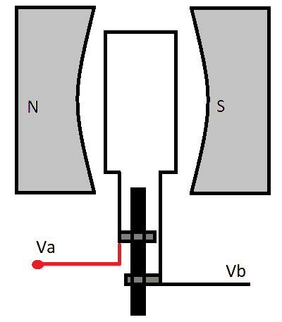

Hi,
Let's say we have a basic AC generator, where a single wire is rotated within two magnets:
Due to the electromotive force, a voltage is generated so that Va - Vb = 120V.
Let's now ground Vb side directly to earth, while leaving Va still open:
We can say that Vb = Vc = 0V and Va alternates between -/+120V compared to Vb.
Now I have the following questions:
1) In the first figure, even though there is no load connected, there is alternating current between the ends of the wires due to potential differences, yes?
2) In the second figure, does the current continuously flow to/from the ground as the right side of the coil tries to "remain" 0V?
I.e., during half of the rotation the voltage generated let's say is higher than 0V, meaning current will flow to the ground and the second half lower than 0V, meaning current will flow from the ground.
3) If the answer to previous question, is yes, can we also deduce that adding some low resistance load L (e.g., 1 Ω) between Vb and Vc would have current running through it?
Thank you for your time.
Welcome to PF.
There is an alternating voltage, but no current will flow.
For any current to flow, you must close the circuit.
No. There is only one ground connection, so no return circuit. The potential of the alternator circuit will be held near ground, but no current will actually flow to or from ground unless you add another ground connection somewhere.
No. There is no current flowing without a return path to make a circuit.

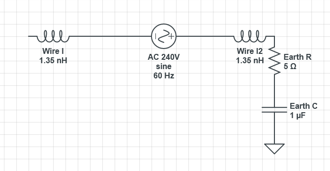

You are missing a complete circuit diagram. You need to show a load on the alternator, and any hypothetical stray capacitance or inductance that you wish to discuss. The value of the load can be unspecified, but it needs to be shown.
"... the other loose end would be also grounded, ..." suggests you will short circuit the alternator through ground. The "other loose end" needs to be clearly shown on the circuit diagram, not just posted in your imagination.
Why will you not post a full circuit diagram?

Well I guess it would be something like this:
Not sure what Earth capacitance would be, infinity?. Resistance assumed to be 5 ohms.
Wire inductance values got from an online calculator (d 2mm, L 1m).

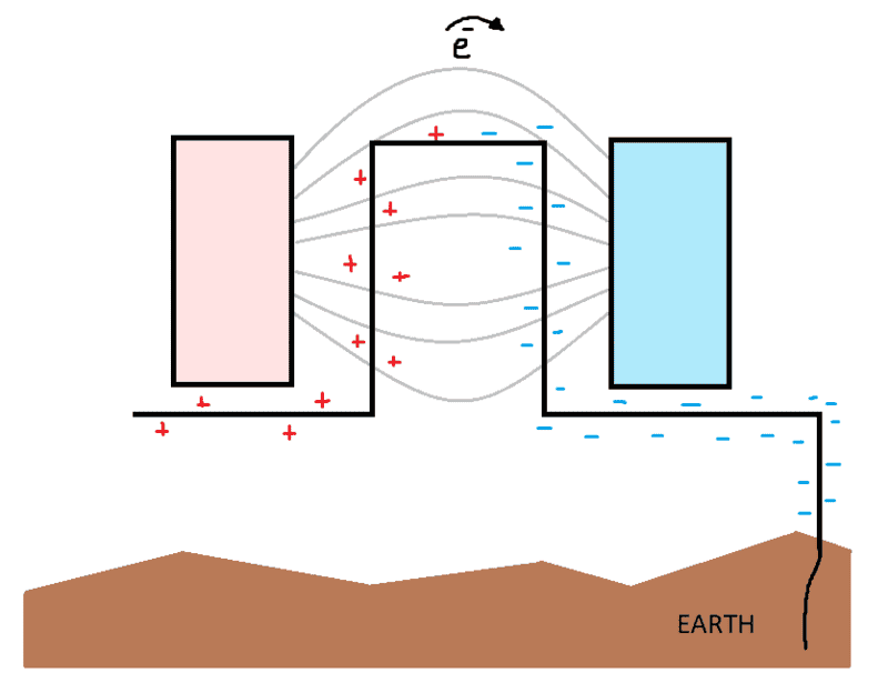

So, yet again, not a circuit diagram, but a picture/concept that maybe you guys could use to help me build my understanding upon, if you have the time:
Please let me know if somewhere I'm making a mistake or missing some crucial part of information:
As the alternator rotates, we're going to have a position where it's parallel to the magnetic field so maximum emf is generated. The charge distribution around the wire spreads near the speed of light. Electrons will slowly start to move - the wire of the generator has billions of free electrons, which now slowly drift to the right.
We consider the movement of charge, or in particularly in a wire, the movement of electrons to be current.
If the wire wouldn't be connected to the earth on the right side, the movement would end rather quickly - the electrons will not "pile" up endlessly, after all, they oppose each other.
But in the picture the wire is firmly connected to earth. And here my understanding breaks down.
I've read from multiple places that earth can receive and give a lot of charge, is this incorrect?
If earth can't receive huge amounts of charge and can be considered to be either a huge resistor or really small capacitor, I think we can end this discussion.
But if not, why doesn't a lot of current flow into it? What opposes it?
The wire has plenty of electrons to generate a ton of current.
How can any current flow here unless you include a finite capacitance between the top left wire end and some Earth? The diagram is incomplete, as a proper schematic. Also, what does the 1μF capacitor represent? What is the 'fat triangle', bottom right supposed to represent and what model are you using to represent the Earth connection?
Every conductor must be terminated somewhere, with a terminal component. If not connected, then there is still a small stray capacitance to nearby conductive objects that are connected to the chassis or building structure. At 60 Hz, those stray currents are insignificant, and they alternate.
The chassis or building is effectively connected to the Earth at one point. Without a second connection, including a voltage or current source, to make a return circuit, there can be no circulating current through the conductive connection to the Earth.
A single connection to Earth will carry only electrostatic discharge currents from the atmosphere. That discharge may include a lightning strike, which may give you the impression "that earth can receive and give a lot of charge", but that is a different electrical circuit, and is not part of the grounded alternator circuit.
The two separate circuits simply share one conductor.
The Earth to cloud capacitor is charged by movement of the atmosphere, or by the "fair weather current". When a breakdown voltage is reached, the lightning strike discharges the atmospheric capacitor to ground.
In your diagram, the wire going to the left will VERY rapidly run out of free electrons to supply any current. Perhaps others here can come up with some actual number or electrons.
In the real physical world, that left wire will have some small capacitance to Ground, the exact value of that capacitance depends on the diameter of the wire and its distance from the Ground.
So to make an actual Circuit you need something that is connected to that left wire AND to the Earth or Ground on the right.
