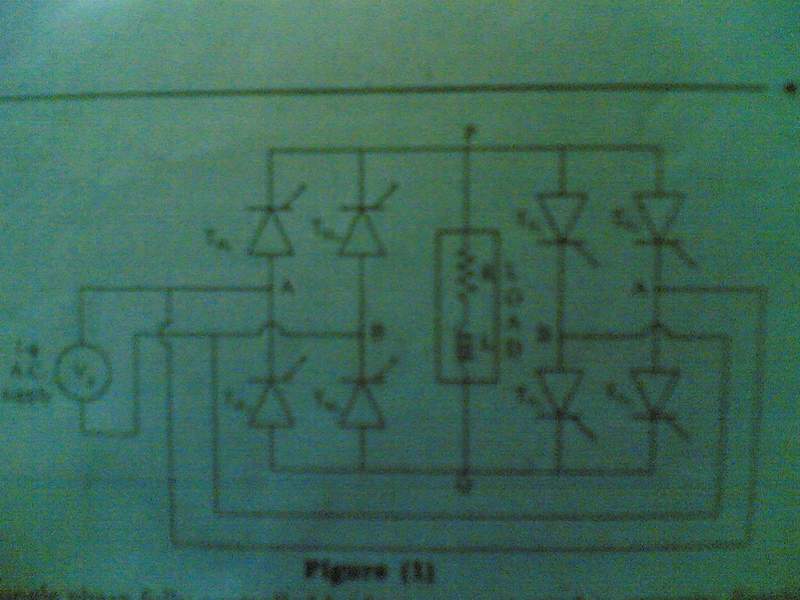

Can someone give me a circuit diagram i can use to change the frequency of AC current?
The discussion focuses on methods to convert AC frequency, specifically changing 50 or 60 Hz power to different frequencies. Key solutions include using a Voltage Controlled Oscillator (VCO) after rectifying AC to DC, and then employing an inverter to convert it back to AC. Participants also mention the use of a 12-pulse rectifier and inverter for larger systems, while smaller systems may benefit from transformers to adjust voltage. The Cycloconverter is noted as a more complex option for frequency conversion, primarily used in motor speed control.
