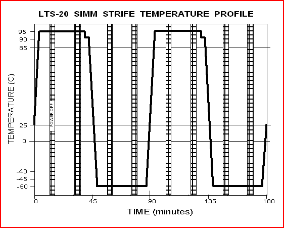

Yeah, there may not be much published in the public literature, since the process was developed at HP to help make the reliability of their products better than their competitors. Many of those of us who worked at HP back then have moved on to other companies, and brought the STRIFE reliability testing paradigm along with us.
Here is a diagram from one of my old Product Design Specification documents, showing the STRIFE cycle profile that I used on that product during reliability testing. You want to put enough test units into the oven to give you good statistics, and you want to run them long enough to give things a chance to break if that part of the design has issues. For larger devices (like PC-size), you can usually get away with something like 10 test units. On smaller devices like network transceivers, you will want to be testing more like 100 at a time. Test times usually ran for several days, with about 90 minutes per cycle. We use liquid CO2 dewars and ovens to get the 10 degree C per minute ramp rates and -50C capability. You will typically test to temperatures 10-15C outside of the operating temperature range specified on the product datasheet. The product below was rated for the Industrial Temperature Range of -40C to +85C.
In the diagram, the cross-hatch periods show when we shut off the power to the UUTs. This is done to be sure that their power supply circuits can restart at both high and low temperature. The little notches in the start of the cooling profile (when starting to ramp down from the highest temperature) are there because the liquid CO2 needs to flow in the hose from the dewar to the oven for a few seconds in order to cool down the hose so that the liquid makes it all the way through the hose to the solenoid valve in the oven. After a dwell time at high temperature, the CO2 in the hose is in the gaseous state, so there is no cooling at first when the oven solenoid opens to try to start the cooling ramp down. That would mess up the 10C/minute integrity of the cooling ramp if we did not wait a minute or two to let the CO2 in the hose cool down.
We've found many problems over the years in product designs with STRIFE testing, and kept those issues from making it into the field in the final products. We've found everything from missing ground connections in inner layers of PCBs, to mechanically over-constrained heat-sinked power transistors, to marginal memory timing issues, to power supply start-up issues at low- or high-temperatures, and many more. :smile:
