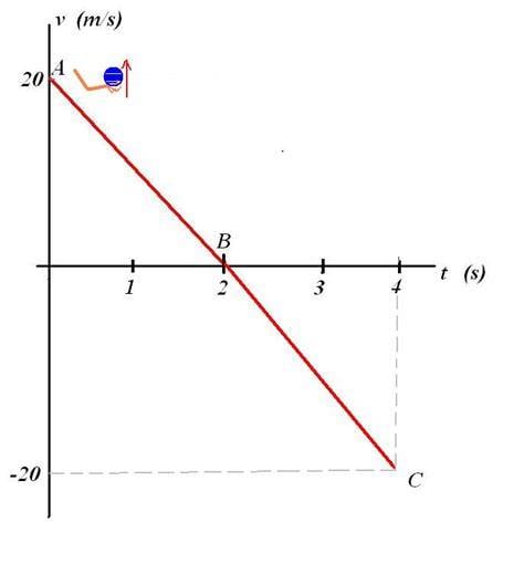

I'd like a go too. Let's say, using upwards is positive, a ball is thrown with an initial velocity of +20m/s. Take g = -10m/s2
The ball's velocity-time graph is this (image from https://socratic.org/questions/a-ba...with-a-vocity-20m-s-it-takes-4-seconds-to-ret ):
The gradient (-10m/s2) is the acceleration; it tells you the rate of change of velocity.
Because we have a straight line, the gradient is the same at every point between t=0 and t=4s.
To find the gradient you could consider the interval from 0 to 4s, or from 0.5s to 3.2s, or from 1.999999s to 2.000001s. You would always get -10m/s2.
The gradient at t=2s (when v=0) is the same as at any other time between 0 and 4s.
