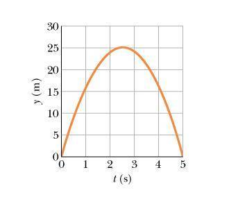

A ball is shot vertically upward from the surface of another planet.
A plot of y versus t for the ball is shown in the figure below, where y is the height of the ball above its starting point and t = 0 at the instance the ball is shot.
The figure’s vertical scale is set by ys = 30.0 m.
(a) Write expressions for the displacement and velocity of the ball as functions of time.
(b) What is the magnitude of the free-fall acceleration on the planet?
(c) What is the magnitude of the initial velocity of the ball?
~I've attatched a pic of the graph.
I have to get the acceleration.
a.) I need help on how to derive a equation from that graph and I don't know what the ys= 30m scale is that they describe.
I do know that since it is x vs. t graph I can get the v from that.
b.) would I solve the equation I derive or use another equation for getting the acceration due to gravity for this? I don't know if I get that from a equation that I derive.

For part a all you will need are the standard kinematic equations. Then for part b you would solve for acceleration using some selected values from the graph. You will have to substitute for the initial speed in terms of acceleration and then once you've found the acceleration you can find the initial speed.

For part b I meant you have two equations with two unknowns. You will rewrite the velocity equation in terms of initial velocity and substitute into the distance equation and then solve for acceleration. Now to get rid of the final speed term you will have to choose a point on the graph where the final speed is zero. There is only one place where that happens. Once you have the acceleration you can then go back and find the initial speed.

Hey christina,
You're ok up until the point where you are choosing the final velocity to be zero. remember the velocity on a distance time graph is the gradient of the curve. So velocity is zero when there is a stationary point of the curve. That means your first guess was correct. Final velocity is zero when vertical distance is 25m and time is 2.5 s. The reason why you don't get zero when you divide the distance by the time is because you are calculating average speed.
Secondly, [itex]\frac{1}{2}at^2 - at^2 = -\frac{1}{2}at^2[/itex]
Ok?

xf= 25m
vxf= 0
25m= -1/2(ax)t^2
ax= -8m/s^2 ===> this would be the magnitiude for the freefall acceleration on the planet.

Personally I'd go with vxf = vxi + ax*t
You can use the same values you used to find the acceleration. So vxf will be zero and t will be 2.5s.
The method you have used is fine except you have made a slight error. Remember that the acceleration is -8ms-2. So you would end up with [itex]\frac{50}{2.5} = a[/itex].

Well I got vxi= 20m/s
