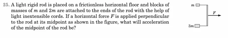

I assumed the length of the rod to be ##6l## for simpler calculations . Here , $$a_{cm}=\frac{F}{m+2m}=\frac{F}{3m}$$
Here , CM is located at a distance of ##2l## from the ##2m## mass . Writing the moment equation : $$\alpha \times \left[ m(4l)^2+2m(2l)^2\right]=Fl\implies \alpha=\frac{F}{24ml}\implies \alpha l=\frac{F}{24m}$$ $$a_{\text{mid}} = a_{CM}+\alpha l=\frac{F}{3m}+\frac{F}{24m}=\frac{3F}{8m}$$ which doesn't match the answer key .
If the rod is spinning about its center of mass, replace the masses with the tension developed in each bar (they say inextensible cords - but I don't think that is consistent ) in the FBD of the rod, and you should be using the thin rods moment of inertial about the center of mass then apply ## \sum \tau = I_{cm} \alpha ##
Scratch that, massless rod. Looks fine to me. Did you notice they put a mass of ##3m## in the diagram?
Another thing, maybe they do actually mean cords, i.e. they don't accept compression? It wouldn't hurt if you gave the answer they expect.
My bad , the answer matches if I took the mass as given in the diagram , i.e, ##3m## instead of ##2m## . The answer turns out to be : ##\frac{F}{3m}## .
Bling Fizikst said:
My bad , the answer matches if I took the mass as given in the diagram , i.e, ##3m## instead of #2m## . The answer turns out to be : ##\frac{F}{3m}## .
That's not your bad, it's their bad!
