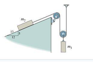

I believe that I have my answer. I would appreciate it if someone could check my work.
m1 = 33 kg
m2 = 14 kg
μ = 0.19
Angle is given by 5,12,23 triangle shown in figure.
Assume pulleys are massless.
What is the acceleration of mass m2 on the incline plane? (Positive acceleration to be up ramp)
Mass 2:
T - m2g([itex]\frac{5}{13}[/itex]) - μm2g([itex]\frac{12}{13}[/itex]) = m2a2
Mass 1:
2T - m1g = m1a1
Pulley System:
a2 = -2a1
Even though acceleration is assumed to be up the ramp, I drew my FBD with acceleration going down the ramp. I know that if my answer is negative it will be the opposite direction of what I assumed.
After I plugged the pulley equation into the mass 2 equation and then solved two equations with two unknowns:
T = 279.8 N
a1 = 7.15 [itex]\frac{m}{s^2}[/itex]
a2 = 14.30 [itex]\frac{m}{s^2}[/itex] (Initially this was a negative answer, which reversed my assumption of the direction)

I thought that my answers were correct but they are not. I would appreciate it if someone could check my work. I can't seem to find where I made my mistake!
I have also attached a scan of my free body diagrams and the equations that I came up with.
m1 = 33 kg
m2 = 14 kg
μ = 0.19
Angle is given by 5,12,13 triangle shown in figure.
These are the equations that I came up with from my free body diagrams:
Mass 2:
Mass 1:
2T - m1g = m1a1
Pulley System:
a2 = -2a1
T = 121.43 N
a1 = 2.45 [itex]\frac{m}{s^2}[/itex]
a2 = 4.90 [itex]\frac{m}{s^2}[/itex] (Initially this was a negative answer, which reversed my assumption of the direction)
What makes you think the answer is incorrect? Do you have answers provided: perhaps they hold a clue?
You could check by simplifying the system - the pulley system offers a mechanical advantage in one direction ... which, and what does that mean?
