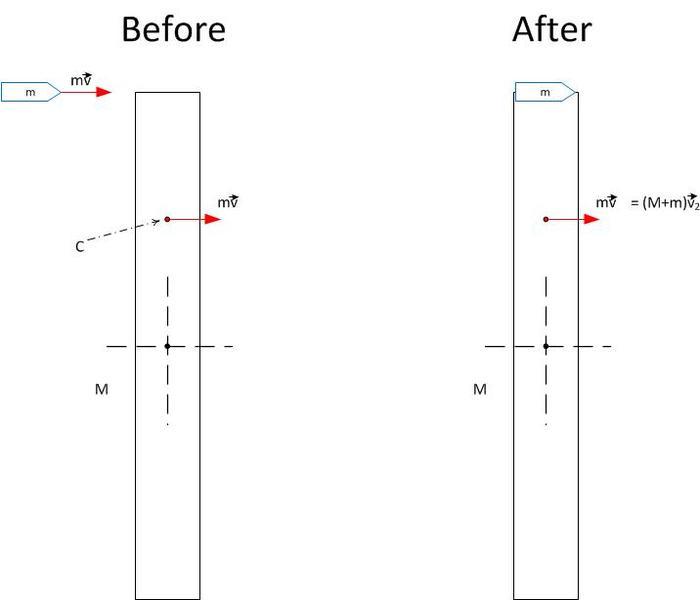

mstachowsky
Consider a bar of length L, mass M, and uniform density floating in free space (ie: neglect gravity and assume that it is not contacting anything). The bar is initially stationary. Imagine a bullet of mass m traveling at a speed v hits the bar at one end. What is the linear momentum of the bar, the angular momentum of the bar, and the linear momentum of the bullet after the collision?
p_bullet = mv before collision
Momenta of the bar are zero, for both angular and linear.
The best I can come up with is that in the collision, we have:
mv = p_bar + Jw_bar + mv2
Where v2 is the speed of the bullet after collision and Jw_bar is the angular momentum of the bar. The problem I'm having is I can't figure out how to find the expressions for p_bar and Jw_bar in terms of the known variables M, m, and v.

I had drawn a picture, but you already describe it so nice that it's almost superfluous.
At least I can explain why I liked m=M: I can draw the center of gravity halfway.
  • Two-panel diagram of a bullet of mass m hitting a rod of mass M. Before: bullet moving right with velocity mv, rod centre C at rest. After: bullet embedded, combined body moving right at (M+m)v2.

Now we come to the rotation stuff. In the picture I had drawn the total momentum before and after and placed it at the center of mass C.
So on the left there is only one red arrow, which I translated from the bullet to the center of mass, i.e. over a certain distance perpendicular to the vector itself.
That translation can only be done if I add angular momentum. Completely analogous to translating a force and adding torque. Torque and angular momentum are pseudo-vectors, but never mind at the moment.
(And now I come to a point where I have to admit my little plan of picking the center of mass to work on the rotaton stuff isn't useful, because we will have to go to the center of gyration. Quantitatively quite some work. My turn to shout help! It's been so long ago I had to do this...). Qualitatively there is no problem, because for angular stuff you can use any origin.
Angular momentum ## \vec L \equiv \vec r \times \vec p ## and it is also conserved (in the absence of external torque being applied, which is OK here). The x is a vector cross product; you know about those?
Pick a point and sum the angular momenta. Lazy me: the top of the bar - at rest. Before the collision: sum is zero. Therefore after the collision: zero also. But now the center of gravity has momentum mv at L/4 distance. So there must be something else moving the other way! Namely the center of gravity of the Bar. (Oh boy, uncertainty whether I should search for the center of gravity, gyration, or still otherwise -- help ! again...)

Spent a while chewing on this. Can't think of something decent with m and M, so continue with m=M. Give it a long shot with angular momentum around center of gravity.
Have to correct the picture too: before collision center of gravity is halfway between center of bar and center of bullet, so more to the left than where is was drawn in the picture. Linear momentum still mv ( =(m+M)v/2 ).
W.r.t. center of gravity:
Before collision: bullet has speed v/2 vertical distance L/4, mass m and the bar v/2, L/4, mass M so (m+M)vL/8 .
After collision center of gravity is on the bar. Now my guess/long shot: look at the (conserved) angular momentum with this point as rotation axis and write it as £ = I ## \omega ## to at least get some angular velocity ## \omega ## .
(I use £ -- a pound sign -- for the angular momentum because the L is already in use for the length of the rod)
I is the moment of inertia and now it boils down to finding he moment of inertia of our bar+bullet around axis through C. A bar mass M length L around axis at end has I = M L2/3.
Bullet at distance L/4: m (L/4)2
bar length L/4: M/4 (L/4)2/3
Remainder of bar: 3M/4 (3L/4)2/3
So something like (m + 7/48 M) (L/4)2
which would yield ## \omega = { (m+M) 2 v \over (m+7M/48) L} ##
but this was for the case m = M.
So say a 1 kg "bullet" hits a 1 kg bar of 1 m at 1 m/s, then ## \omega = ## 3.5, so 1.1 rotations/sec. Who knows, but:
I wouldn't bet on this. Bedtime.
