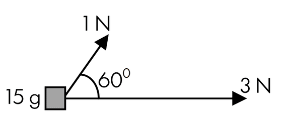

Two forces act simultaneously on a body of mass 15 gram. The magnitudes of the
forces are 1 Newton and 3 Newton, and the angle between them is 60° as shown. Find the
magnitude of the acceleration of the body. Express your answer in m/s2 and to the nearest
integer.
F = ma
The sum of the two force vectors is √{1+9+(6*1/2)} =√13 .
Thus a =√13/(15/1000 kg) = ~240 .
But the answer is very far off. Where have I went wrong ? Please help.
haruspex said:
So do I. What answer is given?
The answer given is 67 .
haruspex said:
You'd get that acceleration from a force of 1N on 15g.
Right ! I didn't notice that . So probably its a mistake in answer sheet.
