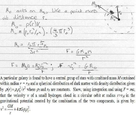

I think I may of been too general with the volume in finding [tex]M_0[/tex]
I'm assuming [tex]r_0 = r_M[/tex] although I'm not sure why different notation is used thougj
http://imageshack.us/photo/my-images/3/gravscan.jpg/

Yup. You need to integrate to find the mass due to the dark matter since its density is not constant with r.
I integrated betwee r0 and 0 and got.
M(r) = 4∏ρ0r30
v2 = GM/r
Not sure where to go from here to get the second term.
M(r) = 4∏ρ0r30
That doesn't look quite right. What happened to the constant ro from the density function?
v2 = GM/r
You should have two mass terms to add together. The first one is the trivial M for the central stars, while the second is due to the mass of the dark matter.
Ah cheers got it now, misread the question was thinking M was the total mass of sphere rather than just the stars contributions.. [tex]M(r)_{dm} = 4πρ_0r^2_0r[/tex]
