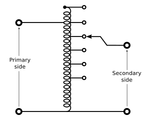

On an AUTO transformer like this:
Schematic of an autotransformer: a single tapped coil with a primary side connected across the full winding at the left and a secondary side connected to a movable tap at the right, with the taps shown as small circles along the coil.
The polarity is normally marked but for safety reasons if the input is the mains power supply. It is necessary to get the active and neutral the right way around.
However getting them wrong will not affect the output voltage as long as the turns ratio stays the same.
