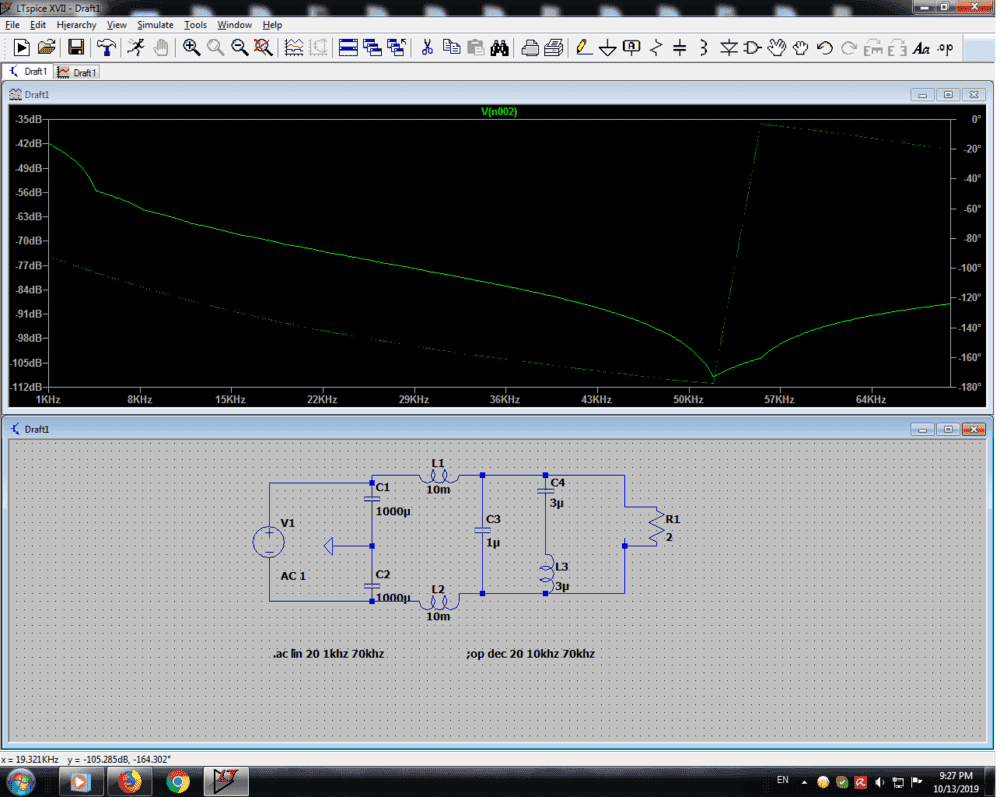

Now I had a few months away for other things that I'm still doing but I started learning LT spice recently so here is my own version of the filter @Baluncore posted here, so may I ask what the author himself thinks of it?
I played around with the values and did an AC analysis of 1volt amplitude from 1Khz to 70Khz.

First the praise; well done getting into LTspice.
Now the constructive criticism.
You increased C3 from 1uF to 550uF. The advantage of the 1uF cap was that it could be ceramic with much lower inductance and ESR than an electrolytic. C3 was needed to attenuate ultrasonic spikes with HF harmonics. Only the 50 kHz fundamental remained a problem for the L3 & C4 trap.
You defeated the series L3&C4 trap that was tuned in the circuit to the 50 kHz fundamental. If L3&C4 are not tuned correctly you may as well leave those components out of the circuit.
Making components in circuits bigger because they appear to work better is bad practice. Components only have to work well enough to meet the circuit specs. Beyond that, they cost space and money.
Spice can lead you to think all components are perfect. For example electrolytics are also resistive, you must think in parallel about component value, availability and cost.

thanks for answering, yes I'm getting into spice slowly at first it seemed a strange program the user interface is meant for learners more than those who seek ready plug n play solutions I guess.
Well I do agree with your criticism and about the component choices, this was not meant as the final version of what I would do but more of a playing around way of learning spice.
So here are a few questions, leaving out the cost and space of bigger/overdesigned parts, why is the larger capacitance in C3 worse than the smaller capacitance apart from that ceramics would have lower ESR? I assume that the goal is to get the noise line as low as possible and for a wider frequency range? Also I don't know for sure whether the switching frequency is perfectly 50khz , depending on load etc it can vary a little I think.
Well just physics wise would i be still better off using that low capacitance ceramic in c3 or can I put multiple smaller electrolytics in parallel? The thing is in SPICE simulation it seems the larger capacitance is better , well maybe I should write in the ESR on cap that I'm using and see what changes, since spice allows such fine tuning.L3 and C4 should be left as is in your original schematic ?
Because the fundamental is at 50 kHz with harmonics above that. It is unnecessary to use more capacitance since there is no noise below 50 kHz. Electrolytics are not much use above the audio range.
Why waste time and money installing components that will not perform?
Simulate it with LTspice, with realistic ESR specified for the capacitors.

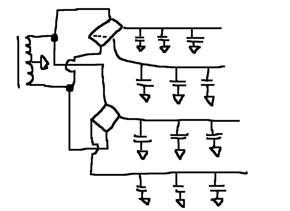

as for my smps secondary filter/reservoir caps see the attache image, there are 12 caps in total each cap is 160v/1000uF.

Firstly, avoid having the reservoir caps on a separate wiring spur. Run DC power and ground rails from rectifier to load, via the reservoir terminals.
Electrolytic capacitor series inductance tends to be proportional to capacitance. Lower the capacitance value until reservoir-ripple ramp-amplitude at full power is reduced to 100 mV, no further. The capacitor self-inductance spike, and ESR voltage step will appear added to that ramp. Too much capacitance will increase both the dominant inductive spike and ESR step.

My psu layout is already such that the caps are soldered in the rails which are thick and run from traffo secondary to output where wires are soldered that go to amplifier boards.
So if I got right , what you are saying is that too much capacitance on the secondary side instead of filtering out the spikes and ripples to smooth DC tend to add itself a parasitic spike which is the result of the capacitor inductance working together with the switching spikes from the transformer output which is the capacitor input?PS. can you or anyone for that matter give me any reference for the ESR value of typical 1n to 100n polyester capacitor? I feel weird as I am searching parts suppliers and various brands but seemingly none offer this value ?
  • #47
If you have more reservoir capacitance than needed, then you also have more inductance than necessary. The terminal and foil inductance of electrolytic caps can be a big problem with switching supplies as it produces a voltage spike at the start of conduction. I am saying use two small caps in parallel rather than one larger one.
