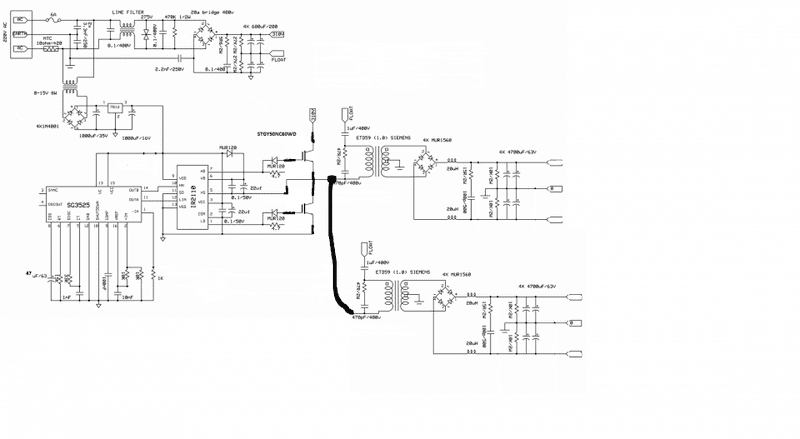

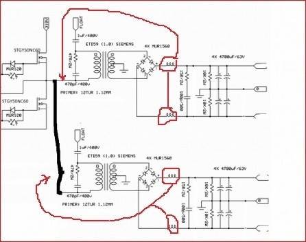

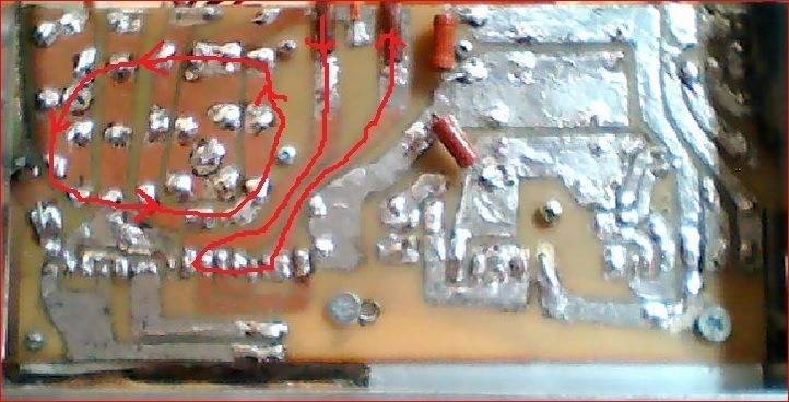

Ok folks, I haven't got much answers lately here and almost none with my last smps ground wire thing but here is another problem I'm facing ,
on the outputs (DC) from my smps after the bridge rectifier diodes and a smoothing filter cap bank I still get about 1V or bit more parasitics which I am almost certain are due to the very switching itself and not inductively induced from the EMI around the smps , I tested this with a scope whenever I put the probe leads across output wires whether ground or +- I get the parasitic waves on the screen on top of my flat DC. when i disconnect and simply fool around with other wires I don't get them , even when very close to the switching parts I still get very small induced spikes much smaller than the ones in the output wires.
I have two transformers each having a secondary and a mur1560 diode bridge and then filtering caps (6x1000uF/160v) per transformer.Also I got additional 100nF poly caps for additional filtering across the outputs and 15kOhm resistors across each transformers rectified secondary to keep the max idle voltage stable etc.Apparently this is still not enough and some ripple or whatever that is gets through, I mean I simply put the scope ground on one side of a fuse and the probe at the other side so that i measure directly across a fuse on either the outcoming + or - and across those 2+cm of wire I still get those parasitics , is there any way to get rid of them ?
otherwise everything is fine but these little spikes get through into my amplifiers and I can hear them in the speakers and that is not nice.I somehow thought about maybe a linear regulator at the output that could drop only a few volts from the output and maybe somehow filter out the noise ? Give me some advice.
P.S. sorry for the bad scope shots it's just that the scope itself is not exactly NASA technology and it's shot by a webcam.
Firstly, what is the switching frequency and what is the frequency of that ringing? 1V certainly does sound bad.
Is you circuit layout sanitary? To reduce the problem of ringing, it is always best to use a ground plane construction with short connecting lands between components and good decoupling capacitors (small value ceramics in addition to the high value electrolytics).
There are so many reasons for circuits to play up like this if you don't follow the rules. Could you post circuits and photos of the layout?
Good luck. This could be a lot of things. High frequencies may be impeded by ground traces and such so this shows up as a voltage. Things we take for granted at low frequencies need to be considered at higher frequencies. I recall helping out on a scope design team and there was a nasty ripple on a high voltage switching supply that they were having trouble getting rid of. I poked around at it for a while and found that there were some things done in circuit layout that caused longer traces to some bypass capacitors and they were next to worthless due to the impedance between them and where they needed to be. Again, good luck.
I am unclear where you are measuring when you say you disconnect and still see the spikes.
Also, when you measure across the fuse, is it at ground potential one end or both ends hot? If the latter, remember one side of the CRO input is grounded.
We can't make progress without some more practical details about the circuit, layout and measurement method.

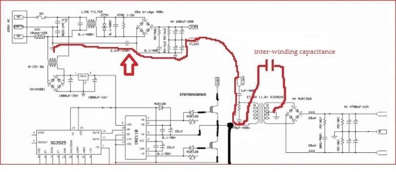

Is this the SMPS you're working on from your earlier thread?

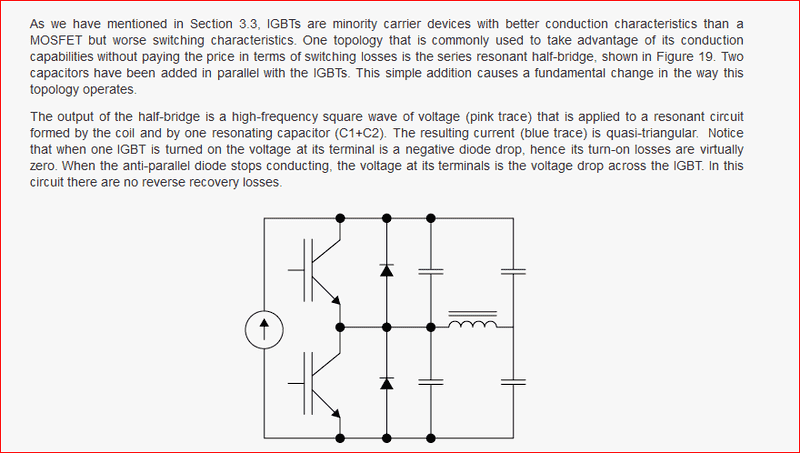

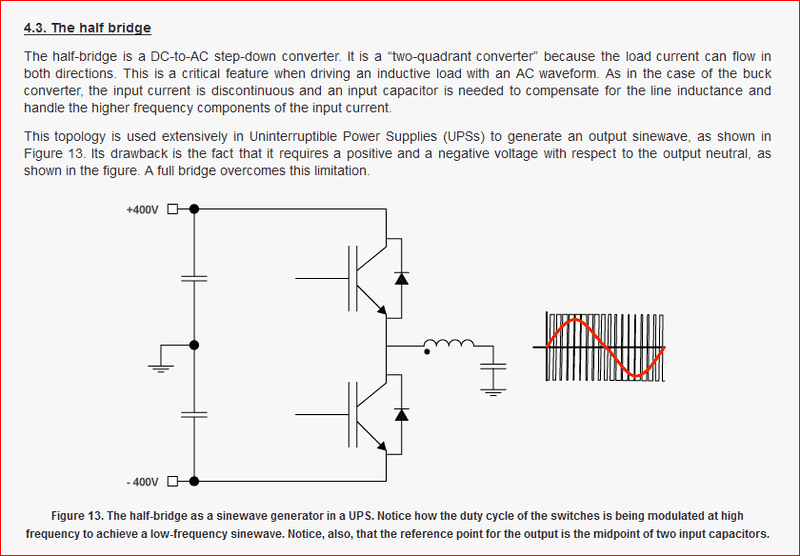

https://www.physicsforums.com/attachments/igbt-nananana-png.94245/
I really dislike SMPS's around audio or precision analog gear for just this reason, the doggone things are 'noisy'..

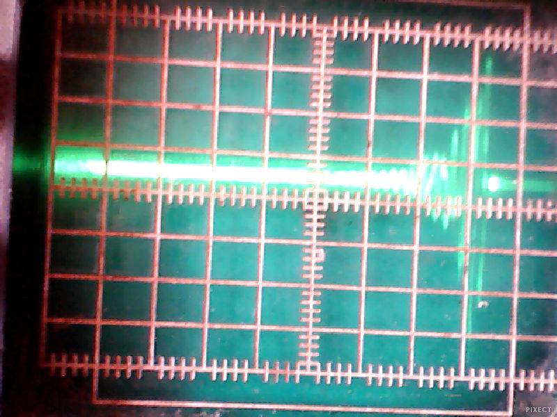

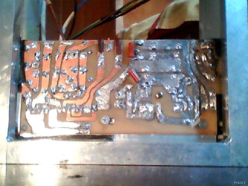

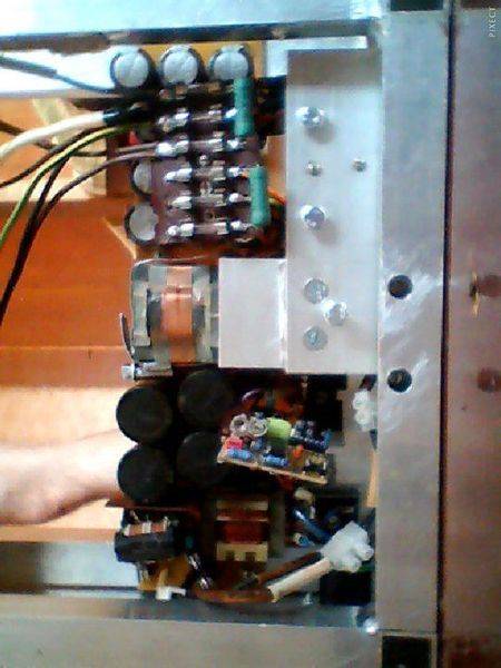

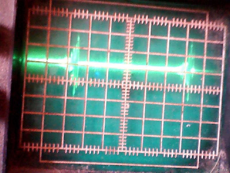

Ok so I made a few pics again with the only instrument I have at hand that makes photos - webcam.the pics are bad quality but you will understand the very overall.
all high frequency traces from driver to switching IGBT's are as short as possible , the only wires that I left going from the pcb to various sockets are either the incoming mains wires and the filtered output DC wires coming out from the cap bank into the fuse plate on top of the smps.
Since my scope doesn't support very high voltages , I simply measured across the length of the outcoming DC wires.since this is high frequency noise it will show up basically anyway.So at first I did a simple test , I took a piece of wire , some 30cm or longer and attached it to my scope ground at one end and probe at the other.
then I switched the smps on and put the wire on various locations around the smps very very close to the parts that are the main emitters of HF EMI noise.
I got very very small to almost no parasitics on the scope screen , then i proceeded and put the scope ground on the gnd wire for example and the probe at the other end were the gnd wire enters the amplifier boards and there I have it , the 1-2volt peak to peak strange looking parasitic with spike tops and sinusoidal rise and fall tops after each peak.
and this very waveform is on every outcoming DC wire on each separate transformer and cap filter bank. I basically have two secondaries and two DC sources for each two channels (4 in total) so it's 90-0-90 from one transformer/rectifier/filter and the same from the other, so in total 6 wires , each one of the has the same exact thing on it , they literally don't differ even though each transformer core is a bit different.
that's all I can say because that's all I know for now.

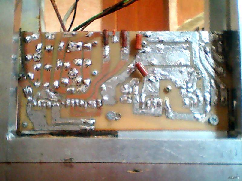

P.S. in the pictures the primary side of the smps has traces soldered and shining the secondary has simply solder points with lacked copper traces.It wasn't meant t be this way but I simply got tired of soldering all the traces so i decided to stop at the primary :D
anyway the traces are thick so their current capability isn't a problem.
in the pics its quite hard to understand the structure of the smps as it had multiple layers at some places also the second transformer as it;s hiding underneath the aluminum heatsink enclosure that I made around the smps it takes heat away not just from diodes and switching transistors but also from both transformer cores as they do get hot under very big loads when I tested close to 2kw.i could make better pics at the weekend when i will have acess to a good camera.

Salvador said:
I do understand diagnosing from far away is hard and probably I will have to solve this myself as with many other things but maybe there are some tips or things I could use to get rid of the noise somehow.
Identifying its source would help.
Magnetic coupling? Capacitive?
Your layout is intuitive to you now , but not to me.

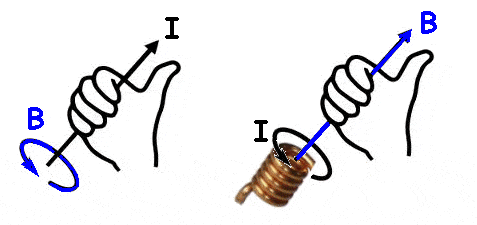

Here's a mental crutch i use
trace out the path taken by your high frequency current then use right hand rule to estimate where the resulting flux goes, and what does it couple.
I have no idea what it'll look like on your board
Object being to minimize areas of the AC current loops
by short wires between transformer, rectifiers/switching transistors, and filter capacitors especially the hf ones.
If any are wires leaving the board use twisted pairs
Ampere and Faraday laws applied !
Then look for large surface areas with substantial AC voltage, envision them as capacitor plates radiating an E-field.
MIght help, i don't know.

well here's the fun fact , i recently rebuilt this smps so that it now looks like this , before it was basically an old pcb adapted to what was at the time just an experiment whether it works at all , so the previous version looked like a thousand times more terrible it had not only ac wires coming in and out of the pcb but also the HF wires from the switching transistors to the transformers going above the board via physical wire , for the first traffo the wire was shorter but to the second one i had to use some 10cm of wire simply going above the board like an antenna.
Now you might say it should have had way more noise , NO it had actually the same amount of parasitics as this smps has now , i measured that and now I am measuring this and to my surprise not much has changed , at least the sound through the speakers is the same.on the GND wire there are only these spikes seen in the pictures above but on either + or - there is also this constant small vibration of the DC line itself I can't zoom into that vibration as to see it's waveform because my scope isn't so precise and I can't focus into it but there is definitely something there.Maybe it's just pure ripple leftovers? Somehow the electrolytics even though I used plenty of them and bought them new from a respectable source aren't enough for the ripple.I have this feeling.

Is this plausible ? (Sorry, i think better in pictures than words)
How could we check for that ?
Will it run without that 2.2nf ? It does seem to bypass your line filter...
Just thinking, not asserting...

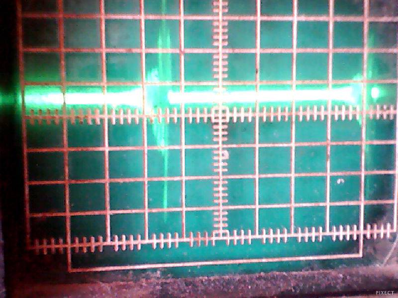

well as for the EMI test yes Jim I connected simply a straight piece of wire between the scope gnd crocodile clip and its probe which represents most of the power wires both in length and shape coming from the psu to the amp boards.I found next to none induced EMI from such an antenna test.I mean if the field around the smps would be so high as to cause all these spikes I should have seen them on a 30cm wire since my frequency is 50khz.
Now just now I measured with scope again after inserting series LC snubbers across the secondary traces. No result whatsoever.This time I measured both across a single wire coming out of the psu and also across gnd and + and then gnd and - and basically everywhere is the same ripple parasitic I was talking about.
As for the grounds , no the secondary grounds that are with respect to the +- DC voltage are not connected to chassis nor to the primary side , the primary side is totally unconnected to anything in the secondary side. the aluminum box chassis is simply connected to the mains earthing plug in case lethal voltage would appear on it.but my wall socket as with almost every socket here in former USSR has no earthing wire so that trick is basically useless I just did it for fun.:dbut that doesn't concern me since I am very cautious about electrical stuff due to my various " dance routines" in the past when mains AC got me dancing.
at this point I'm almost as I said sure that what I measure and see is nothing else than ripple , twisted and bent but ripple.it's on both secondaries , its nowhere else but only in the DC filtered wires coming out of the psu and its in them no matter how you measure it literally rides on top of each wire no matter whether gnd or +-.
I also did the AM radio test and yes there is an audible interference especially right after the moment when t's plugged in then it tends to get lower.but putting the radio further than about 60-80cm seems to completely eliminate the interference.But radio I think is very sensitive to weak signals.
well either it's emi induced or it's ripple there isn't much else it can be I think but if it were emi it should have showed up in the wire I had around the smps a various places with scope attached because none of my dc power wires coming out of the smps are that long.

What about that 2.2 nf from primary side to gnd ? The one above red arrow in post 11 ?
You show same gnd symbol on secondary. That 2.2nf cap and the interwinding capacitance of hf transformer completes a ground loop for 'switching frequency current' . See red loop.
What experiment can you devise to rule out that hypothesis ? Will the supply run with that cap temporarily removed?
oh sorry Jim that cap is non existent in my smps , i never bothered to install some stupid caps across strange places.
i will add the updated schematic to this post if that makes it any better.

A voltage divider, 1meg::10K would give you ~100::1 turndown but it'd round off the corners a bit due to scope capacitance.
With all your constraints it's pretty tough going.
my approach would be
1. Try to find and fix the source upstream of transformer
or, failing that
2. Block it downstream of transformer.
1 will involve changing things to observe changes.
Just out of curiosity
is this line filter also not in the circuit?
If not, does shorting it out change anything?
Tech99 suggested in post #9 an ingenious "Poor Man's Current Probe" .
Lastly -
Are these two caps necessary?
50 khz means ten microseconds per half cycle?
An amp into a microfarad is a volt per microsecond... cap accrues ten volts per half cycle, subtracting from supply voltage to transformer
but gets added back to supply voltage across transformer when transistors swap state
that sounds spikey to me.SMPS's are not in my zone of competence
but I've chased a lot of noise in my day.
Keep us posted , I'm really curious. I try to learn something every day in hope of someday knowing something !
thanks Jim for sticking with me since there are only a few people here that do that. :D
I have a simple line filter , it consists of two caps in series across the AC input just before a choke.that's about it.
the capacitors that you've outlined and asked whether they are necessary make the half bridge topology if I'm correct, removing them means that the upper high side switch would put the rectified +325v DC right between the mains filter caps so at ground potential at one side of the cap and +325 at the other now the two switching transistors would switch 325 volts through the primary instead of 160 which is half the mains rectified because there is another cap in series.
I don't know how that would work but one thing it would do it would double the output voltage from my transformers. probably also double the power.
but some folks once told me that it doesn't work like that without that capacitor.
Okay , thanks, i learned something today , the caps are traditional . I'll fgure it out more deeply over next day or two, plodder that i am. As i said SMPS is not my world.
from http://www.irf.com/electronics/topology-fundamentals
Now - how should one choose the size of that righthand capacitor ? (your 1 uf's)
What happens to your spikes if you tack another 1uf across each to make them 2 uf? Anything? If so it's a clue, if not, well it's back to the drawing board... a quick enough experiment.
Also study your layout - how much Z is between those two 'ground' symols with your layout (they're your little triangles) ?
Further down that same IR appnote
i do not yet grasp quite how that works . Your young facile brain will pick it up more quickly than my old dinosaur one..
old jim
the second schematic differs from my topology since the half bridges also come in various forms.
about the capacitor I actually have 2.2uF in there.
what do you mean by Z?
Impedance.
2.2 uf is 1.4 ohms at 50khz
Is amplitude of your spikes affected by changing the value of that capacitor?
that's a good question definitely not one I can find out easily.
I will try to desolder the caps and put some other in.but I wonder can the spikes be transmitted further if they happen at the gate drive level.
I have seen these spikes at the turn on of the upper transistor moment and a smaller one at the turn off.
but that is gate drive , the rectified DC power is + so when the upper transistor comes on all it can do is to switch that rectified DC to the load which is the primary winding so I tend to think that wherever they begin they can't be associated with the gate drive also because of one reason that gate voltage of a given IGBT can only open the transistor either a little or fully , anyway the current direction is the same just the resistance through the device changes and the square wave rise is sharp and unaffected by the small spike at the gate, so I guess the main problem could be that the secondary output spikes are happening at the transformer somehow.
Rather than unsolder them, might you just tack in some more across the pads?
I have no phenomenon in mind, just looking for something the circuit is sensitive to...
Stray inductance and capacitance gives this sort of symptom
see around pages 10 to 15 here
http://ecee.colorado.edu/~ecen5797/course_material/layout.pdf
and this short one from TI about snubbers
http://www.ti.com/lit/an/slva255/slva255.pdf
seems to me you addressed snubbers long ago in a thread far away... may be snubber circuit needs a tweak?
I still think you have a common mode trouble because it's n all 3 of your output wires.
The ecee.colorado link discusses how that comes about, starting around pdf page24 of 38.
That capacitor you don't have in is one of the suggestions...
Remember this loop ?
Ok reporting back , what I did was take out one of the two transformers , disconnected it electrically , the one I wasn't sure about whether it dosn't have an airgap in the middle.
Now the noise is much much lower.Before it was about from peak to peak about 2 volts in amplitude now the shape has changed and i's amplitude is 0.2v or about 150-200 mV.when I connected the speakers I couldn't hear any noise anymore just the typical " SHHSHSHSH" hissing type noise coming through an amp if it's input (pc soundcard this time) is turned all the way up with no signal.
also another interesting observation is that I have a rheostat potentiometer soldered in for both the frequency control and also for the manual adjustment of the permanent duty cycle and i turned the pot so that the duty cycle expands at the end of the pot i started hearing parasitic noise through the speakers again so i tunred it back until the noise stopped altogether.
I think what I need to do is either make one bigger transformer for this half bridge and just power all 4 channels from that or take that second one i disconnected out inspect it and replace it's core with hopefully the same ferrite that the other one has or very close otherwise they are a bit mismatched and that causes problems but I guess I will go for the one big thing and done solution.
I mean people talk about that if each channel has a separate supply it sounds better and etc but then again they say that tube amplifiers outperform transistor ones and I've listened to both and apart from softer and more likeable mids everything else is the same or worse so that is pretty much nonsense i believe.
it could only sound worse if the rails sagged badly with the one transformer , although maybe i will try swapping the core of this traffo as I already have made all the chassis so that it fits and I'm lazy to overdo the darn thing .
the transformer playing now has a core that I attached from 4 separate E core with glue and each E core ahs numbers F1 67 written on it when I google that I get no results.
